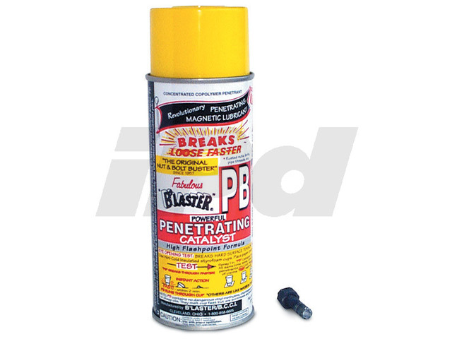

If you're going to make a salvage yard run make sure to bring some penetrating oil, not WD40. If you don't have a preference, PB blaster works great.
