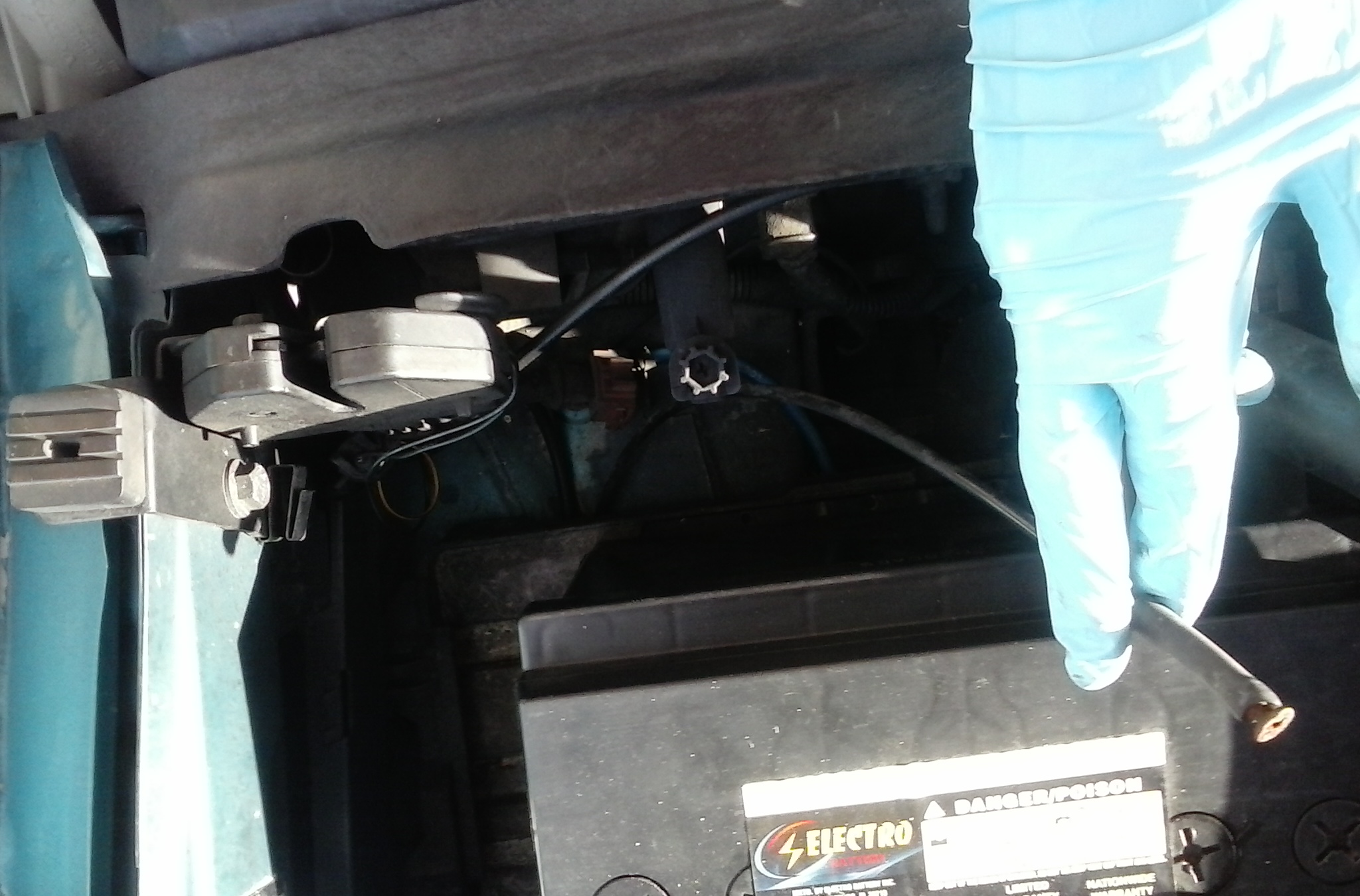

Just disconnected the glove-box light switch before writing this. Went to the car just now and it wont start. lol There's a clicking coming from the area of the shifter when cranking. Going to try jumping it when my buddy gets here.

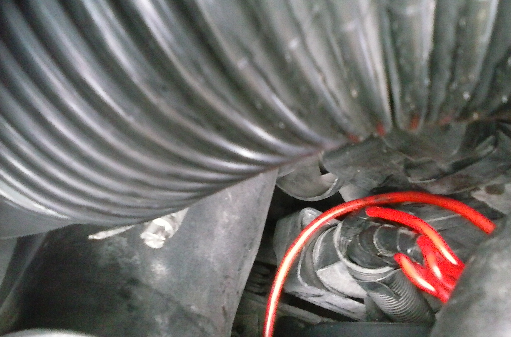

  • There are a few cracked up rubber elbow hoses around the engine. (See Photos)

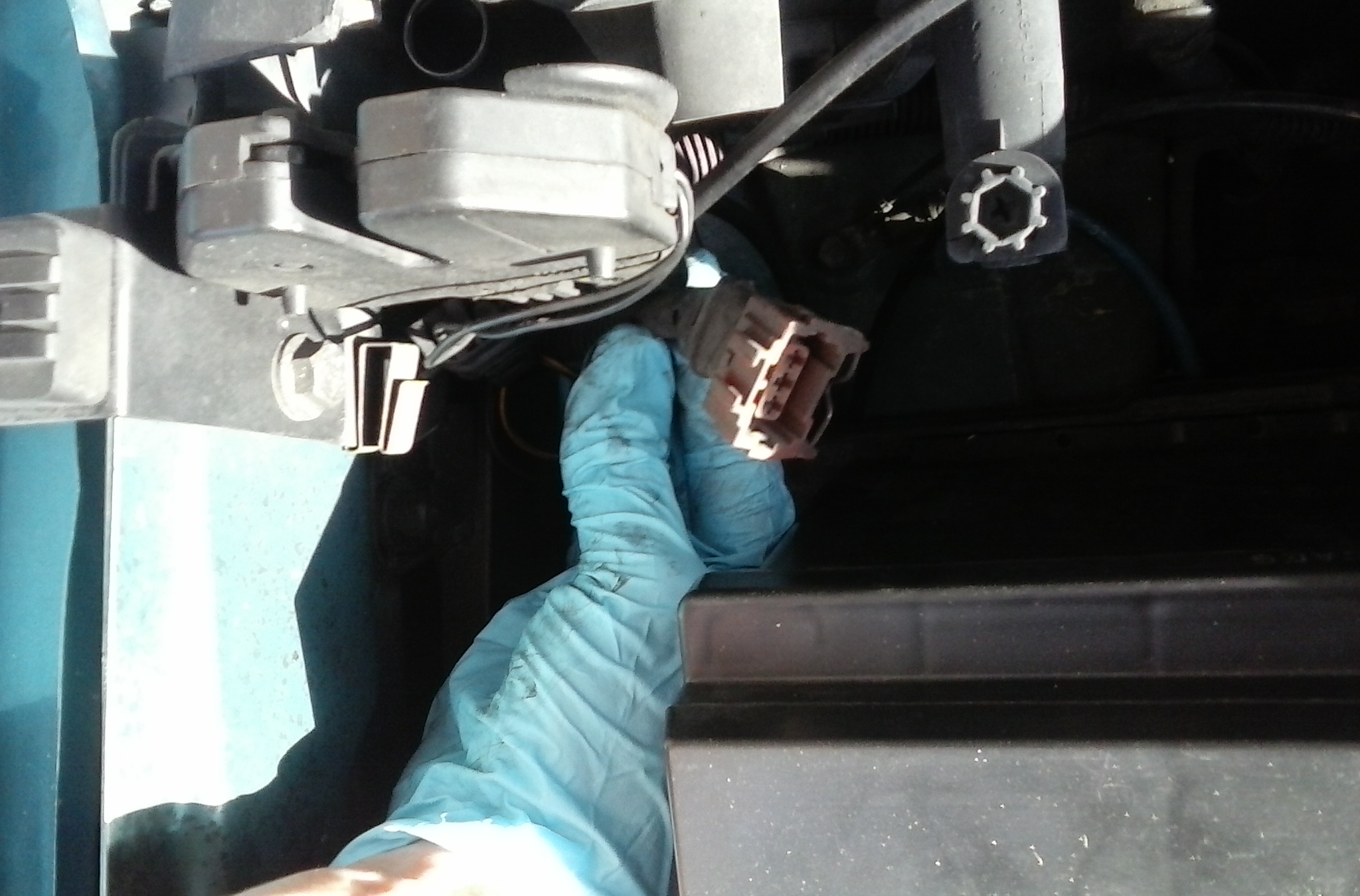

  • There is an electrical connector that's not connected to anything hanging near the front driver side engine bay. (See Photos, No idea what it's for.)

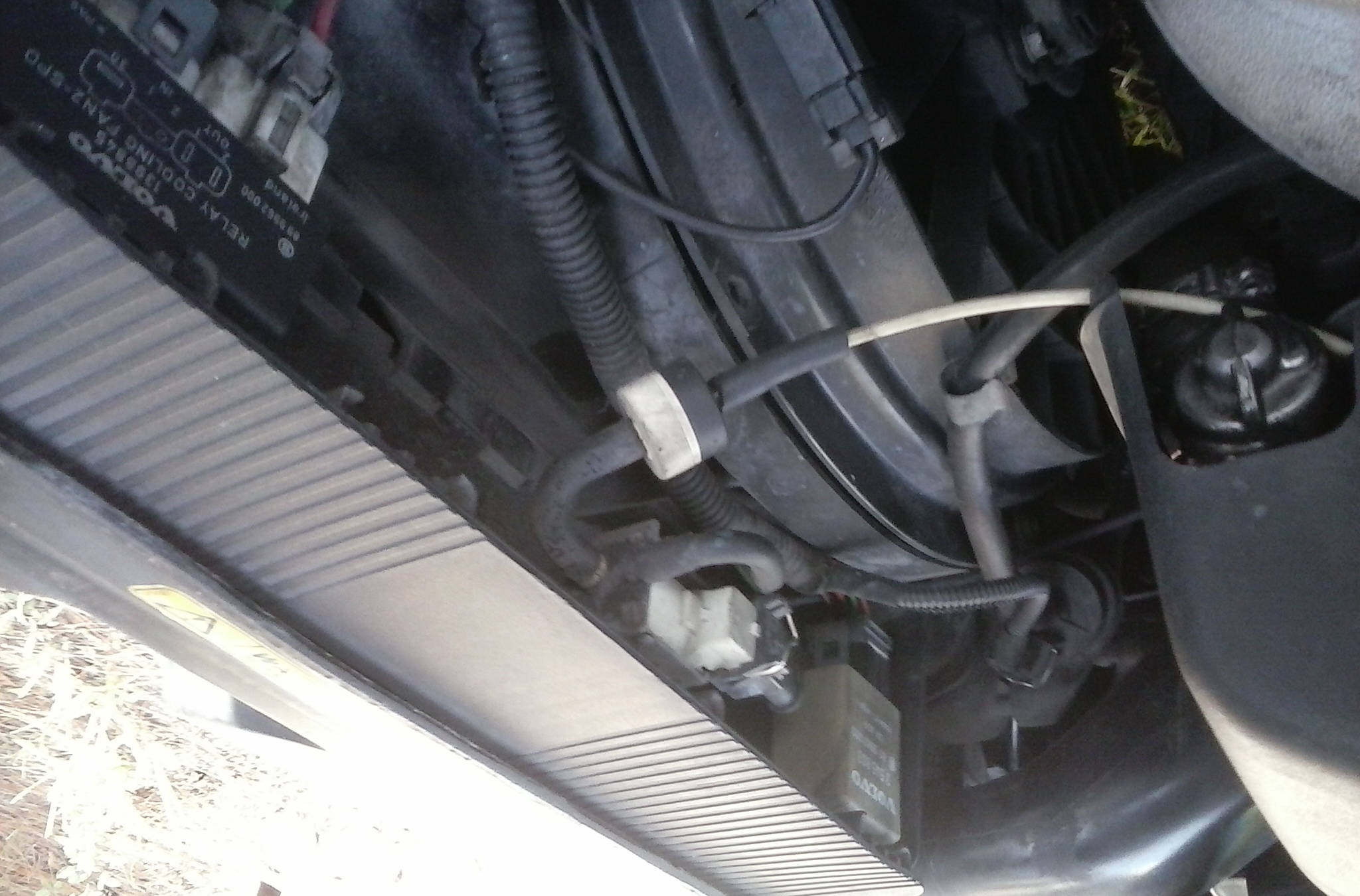

  • Rubber hose with a screw driven into the end and disconnected (See Photos, No idea what it's for.)

Pics 4, 5, and 7 are all related to your headlight wipers (or lack thereof).

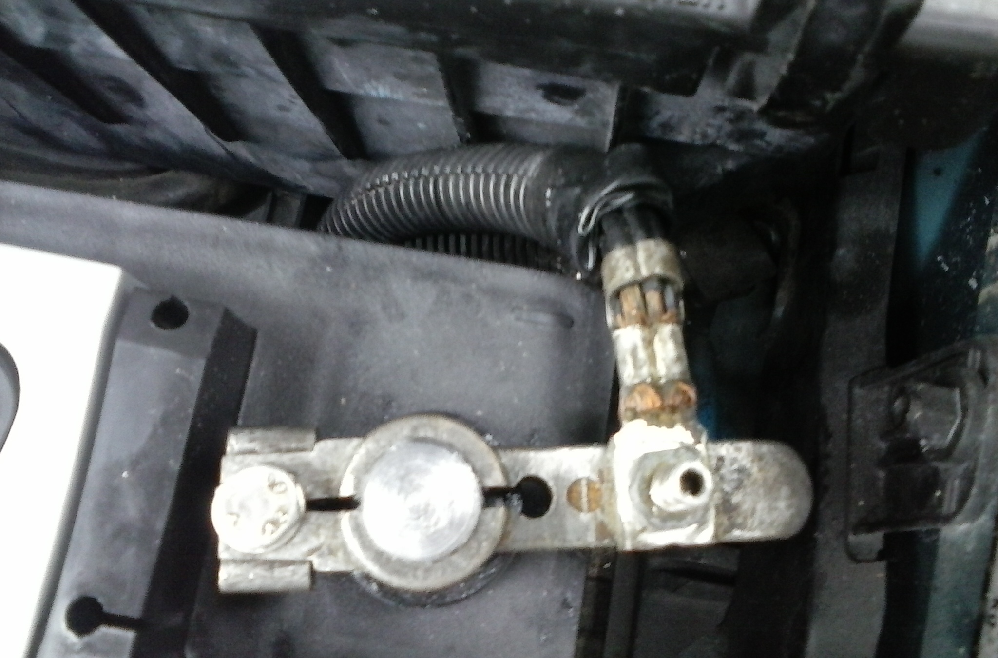

Found that the positive cable being in bad shape will cause drain/starting issues. This one is corroded and broken. Just got back from Harbor Freight with some cheap tools and terminals. After the rain clears up going to tackle it. This thread http://www.matthewsvolvosite.com/for...hp?f=1&t=61747 is a great DIY Walkthrough.

Also, about your screw-plugged hose, I just wanted to mention that the sticker on the bottom of the hood is not 100% complete, but it'll be the most accurate thing you'll find for that particular car. They vary.
It is possible to resolve lost hoses on the internet but not easy. I have a 96 N/A parts car that runs, so I should probably confirm that vacuum hose you pictured. Before I do that, I think that may have been running to the purge solenoid. If the purge system is disconnected, then that'll give you that "code that means you need a new gas cap."

Posting late but here are the results of the positive terminal repair and new battery. Also replaced every fuse in the fusebox after dousing it with CRC QD Electrical Cleaner.
The trunk light's bulb was also burnt out and the switch in the on position. Pulled the cover and confirmed that the contacts are apart and in the off position.
Been starting and running fine but time will tell. Battery was $120. The wire jumble (6 or so wires feeding into a single connector) from the positive terminal is taped up and pulling the shroud back shows 1 of the wires having been joined with heat shrink around it. It appears that it feeds to the fuse box...
The negative terminal also looks to be in bad shape but will bo too short when cut that replacing the entire negative cable looks to be the most complete solution.
