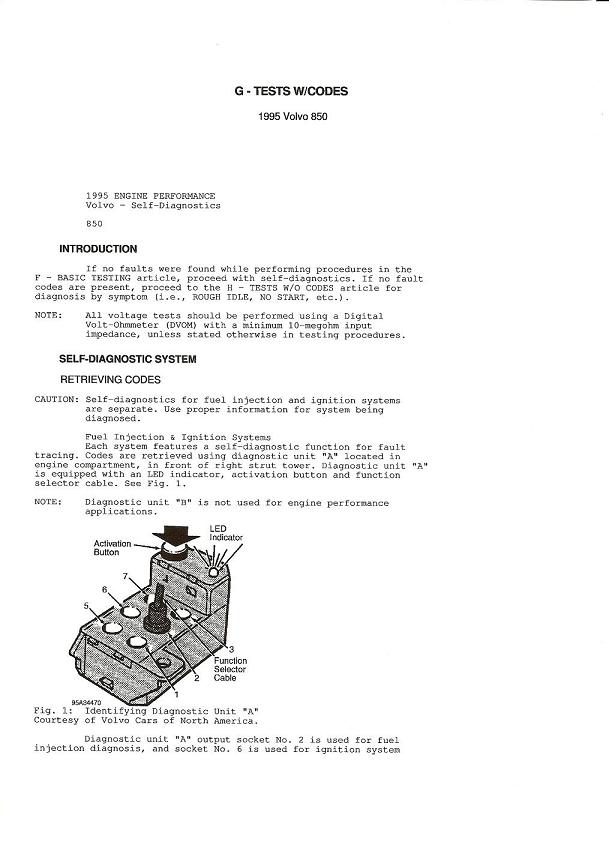

Is Check Engine Light on?
Try retrieving fault codes from the ECU:
http://volvospeed.com/Repair/a2.html
Your 850 is 1995 model so it has OBD-I terminal.
See attached for additional info.
Let us know if you need further guidance as to retrieving fault codes.
JPN
Attached Thumbnails New cam sensor and still wont run...-850-eng-compt-ecu.jpg   New cam sensor and still wont run...-850-code-1.jpg   New cam sensor and still wont run...-850-code-2.jpg   New cam sensor and still wont run...-850-code-3.jpg   New cam sensor and still wont run...-850-code-4.jpg

i fixed it. it was the fule pump. thanks for all the help!
