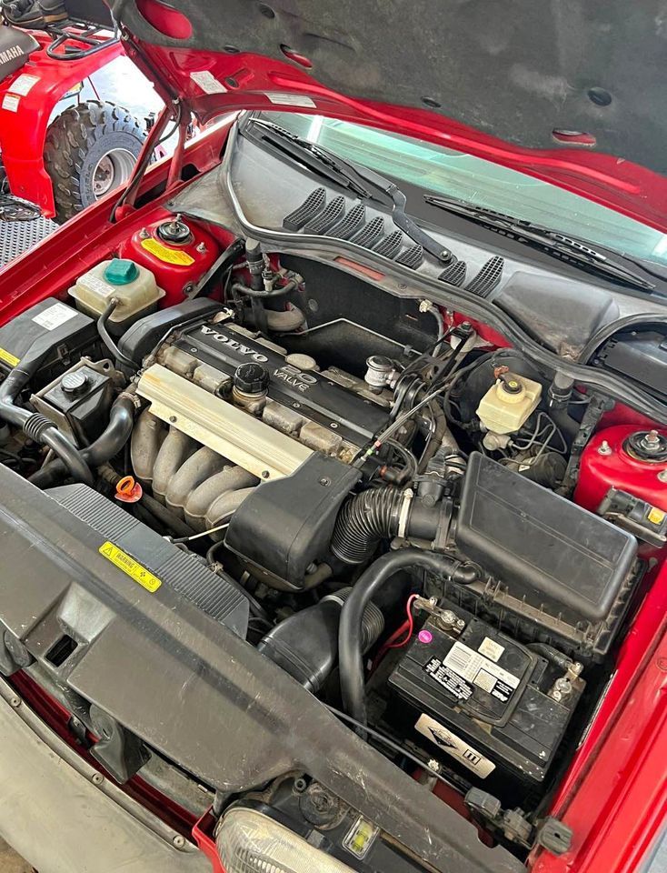

and regarding the heating problems these cars have i live in arizona so this is top priority. This is the text i was sent by the seller regarding this open pipe in my engine bay.
"It could be because the preheat pipe was removed, since we live in a hot climate, leaving the preheat pipe on can cause the flap to stay stuck open causing the o2 sensor to break. I bought this car off a volvo private seller, he has his own private dealership specializing in Volvo. I can give you his phone number and you can ask him any questions you have with the car" Any advice for preventative maintenance for cooling or aftermarket solutions?
It is a non turbo just for reference.
"Nice set of coilovers for daily use" is total nonsense to me, sorry. You might as well have said "My brother in law convinced me to install hydropneumatic elastomers". I have no clue what that is.
you picture is the place where the preheat pipe hooks up. Ignore that. You can buy preheat pipe of various diameters at an auto parts store, but it doesn't do a whole lot.
