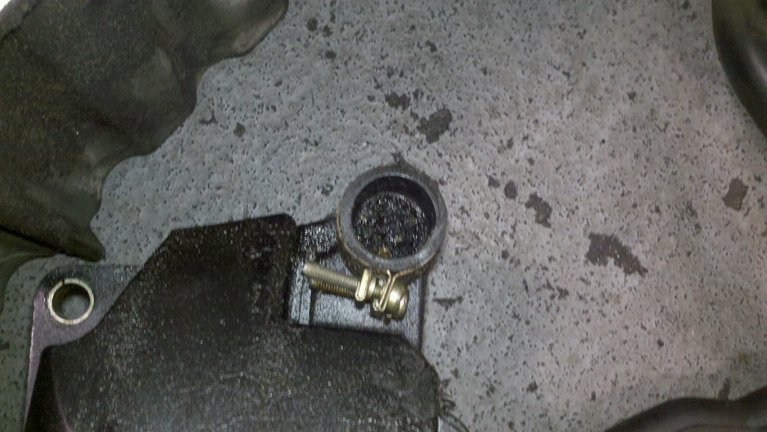

The thing on the PCV is that you likely don't need the black box. It can be rinsed out with cleaner and reused in most cases. It's only a box with little baffling. Unless you see a problem with a plugged passage it's likely reusable.
I have not yet tried to see if I can get just the hoses and how much they would cost compared to just getting the whole kit.
From what Rspi has posted there is a difference in the quality of the hoses in different kits and he said (IIRC) that the cheaper kit the hoses started to degrade after a year or so. Since it's the hoses that are the most important I would go with "OEM" or Volvo hoses.
Attached Thumbnails New volvo user and some questions!-pcv-breather-system-kit.jpg   New volvo user and some questions!-pcv-cutaway.jpg   New volvo user and some questions!-pcv-box-plugged-port.jpg
