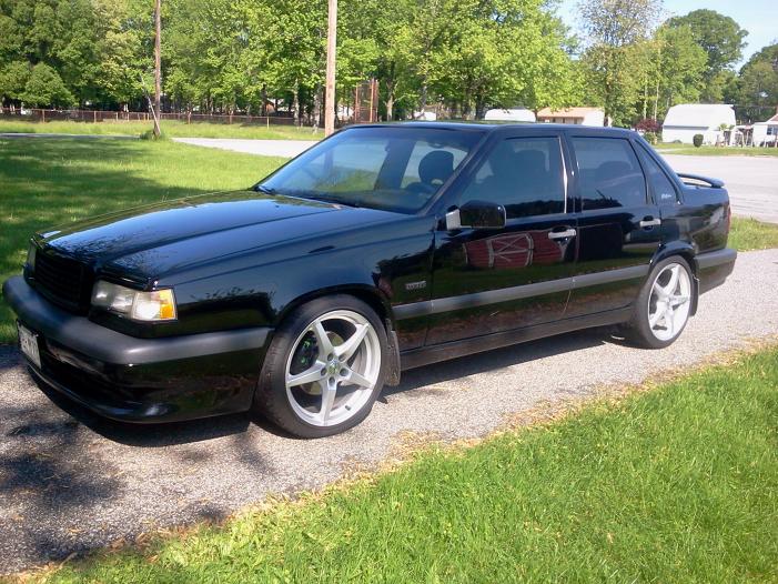

I have been hearing a noise up front on my car only at slower speeds over bumps. I have replaced about everything up on the front end.
Bilstein HD struts ,strut mounts and inserts..year ago
Eibach springs & sway bar links.. two years ago
tie rods....year ago
ball joints..half year ago
after doing this it rode good for a while. Than I started to hear a noise from the front passenger side. It sounded like maybe the rubber strut insert was torn so I replaced with ipd's HD strut inserts. Thought noise was gone drove good a couple of weeks. Than noticed going over bumpy rodes sounded like strut bearings were bad so I got ipds upgraded strut mojnts put them on, and now car squeeks when going over small bumps at low speeds. Drives me crazy. If I stand in front of the car and push on bumper it squeeks real bad almost sounds like I can spray wd 40 and it will go away. I am sure it is probably more serious than spraying some lube on it.
Looking for any suggestions on what to look for.
