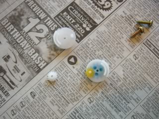

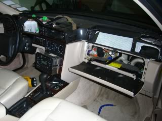

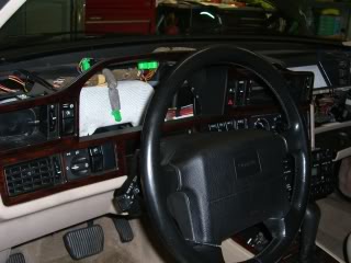

I've uploaded some photos in case you're interested. I'll have to take another shot at night with everything back together again but I was way to tired last night to even think of taking a picture. Anyway, here they are:
Dashboard Apart

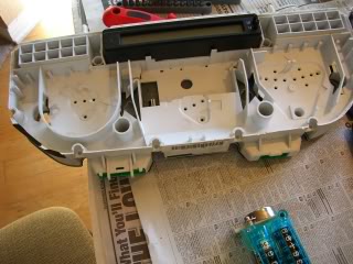

Odometer Housing with Gauges Removed

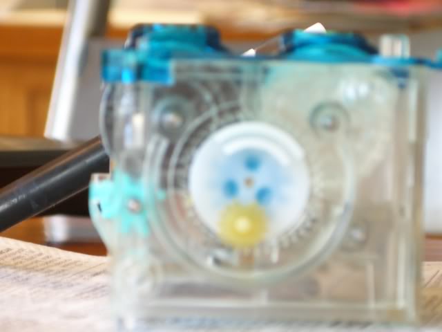

Odometer Gear Assembly

Old and New Odometer Gears. Notice the one tiny tooth that broke off to cause the whole problem.
