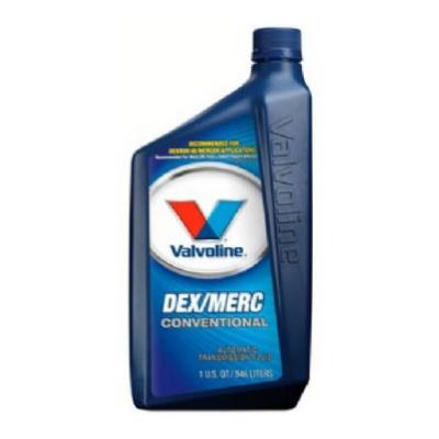

Old Dec 14, 2012 | 06:01 PM
  #88
Originally Posted by Volvomotoringdutchman
Hey kiss4afrog. Yeah I pretty much figured. Was hoping that kerosene flush would have magically taken the water out. One can dream right?
You likely did get most of the coolant out with the kerosene.
Well the thing is if you had an engine that had normal maintenance then running the kerosene or a quart of trans fluid (higher in detergents) or a commercial engine flush additive should pretty much clean it up. At least I've only needed to do one LOF after an intake or head job. Cheapest oil and filter, let it sit and idle up to temperature and a little while more, dump it and use the good stuff and good to go. Sometimes it will look a little off but as long as it's only a little I let it go. Never had a problem.
IF ... it was neglected then you might have all the coolant out from the failure but you may have loosened a whole bunch of caked on crud that is now falling into the oil. You may just have to visually monitor it and change it earlier as it starts to look to be in poor condition. It might be 500 Mile or 2500. Doing a few back to back low mileage LOF's might not be the cure just expensive with little results.
When you pulled the head did you notice an excessive coating of sludge ?? Whatever you saw in the head is likely in the block and pan too.
