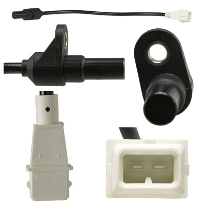

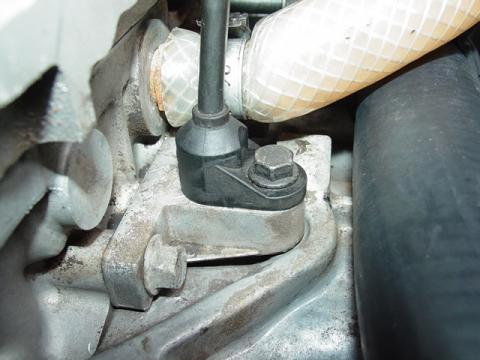

  #106
The Crankshaft or RPM sensor is sticking straight up from the transmission where the bell housing connects to the block. Straight up with a loom coming out of it.
In that last picture (sorry it came out small) it's No.11 and under the distributor.
Attached Thumbnails Please help!? My 850 ran fine until I actually REALLY needed it!? (Failed Tensioner)-crankshaft-position-sensor-4-pic.jpg   Please help!? My 850 ran fine until I actually REALLY needed it!? (Failed Tensioner)-crankshaft-position-sensor-1.jpg   Please help!? My 850 ran fine until I actually REALLY needed it!? (Failed Tensioner)-component-locator-850-engine.jpg
