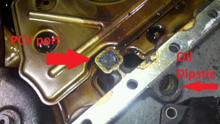

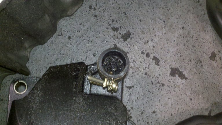

The bottom of the PCVs black box is where that clogging can take place. It's best to try and make sure the passage from the bottom of the black box into the engine block and then into the pan is clear.
Attached Thumbnails PTC questions-pcv-box-plugged-port.jpg   PTC questions-pcv-drain-holes.jpg   PTC questions-pcv-oil-pan-passage-blocked1.jpg   PTC questions-pcv-oil-pan-passage-plugged.jpg

ES6T: I do have some pressure. I am planning on replacing the kit tomorrow or Friday.
Kiss: I have read that. What is the best way to clear those? With chemicals or just scrape it out?

You will only be able to see the ports through the block to outside. The only other way to see the entire passage is to pull the pan.

You can scrape out what you can, and use carb cleaner to get out what you can't see. Before you put it together, blow compressed air into the lower hole and see of you can hear the air coming out of the oil dipstick tube hole. Then, change the oil.
