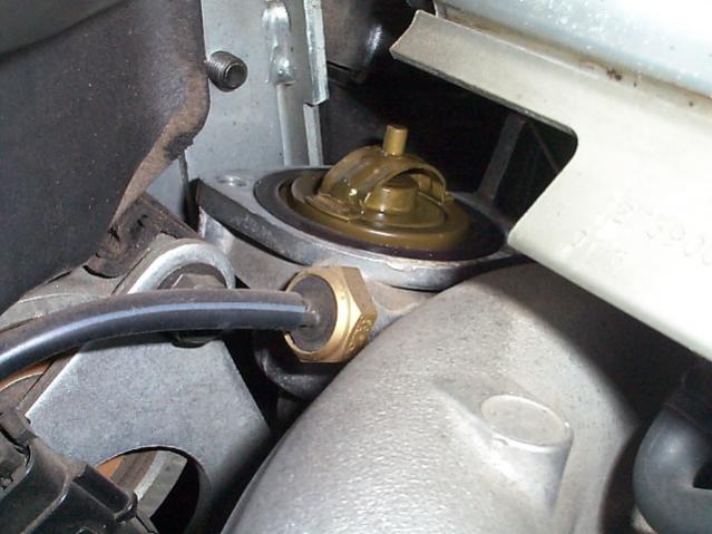

Do you have a check engine light ??
You might have a bad coolant temperature sensor or one that's disconnected or the wire is open.
Attached Thumbnails Raditor fan problems-coolant-temp-sensor-installed.jpg   Raditor fan problems-coolant-temperatur-sensor-new.jpg
I think this is the most likely culprit. It looks like the temperature gauge is reading low. At normal cruise speed (35/40), the temp gauge reads about the 4/5 o'clock position and at a long idle, it sits at 3 o'clock with no fan. If the fan does click on it's only for a second or two. If I touch a lead from ground to the yellow wire connector on the fan relay, it spins great.
