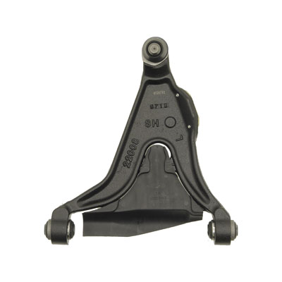

95 850 GLT wagon- I know the general practice is to replace the whole lower control arm, (fronts) but does anyone ever just replace the bushings / ball joints? Theres a shop down the street that could probably press them in. Any places where I might source those parts? Just looking at all of my options...Thanks! Dave
Old Nov 14, 2012 | 07:24 PM
There were control arms with replaceable ball joints. They were aluminum and the ball joint bolts on. The stamped steel control arms have a built in ball joint and there isn't a replacement for just the ball joint.
Bushings are available

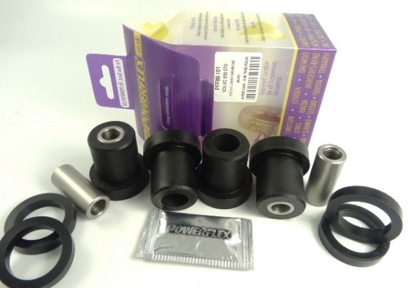

There are also polyurethane ones available
Polyurethane Bushings, 850, S/V/C70 - ViVA Performance

Depending on what it costs you to get the bushings and have them installed and the trouble of pulling the arms it might be better to just replace the arms. That way you get new bushings already installed and a new ball joint. If it has enough miles to take out the bushings it's a fair guess the ball joints might not be in the best shape either.

I picked up 2 good arms for $19 each. After several months I have one bad ball joint so I will replace that. Yes on my '95 R.
The dealer wanted $179 per arm so I feel real good about my decission. Also, you can install poly if you'd like. They may last longer and will be firmer if that's what you want. You can get a set of arms for $120, decent quality that will likely last you 5 years, 75,000 miles. I hope to put another 200,000 on my car so I wanted to be flexible.
