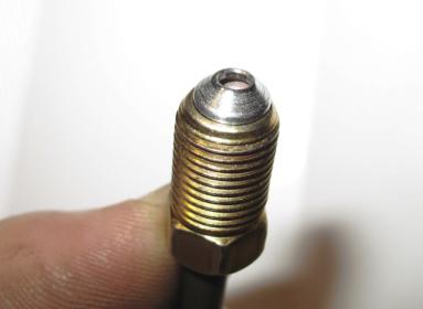

OK, it turns out that FCP doesn't have the hard lines in stock anymore so I've ordered a flaring kit - AutoZone and Harbor Freight didn't carry them in-store - and I've been practicing my bubble flares on a 'practice' pipe I bought. I think I'm doing pretty good.
So I feel confident that I can do the real lines on the car, but one question; when I cut the line and start to flare it, the brake fluid will be dribbling out of the pipe. Is that going to be a huge issue? If I drain the system first, won't that cause damage to the master cylinder? Any suggestions?
