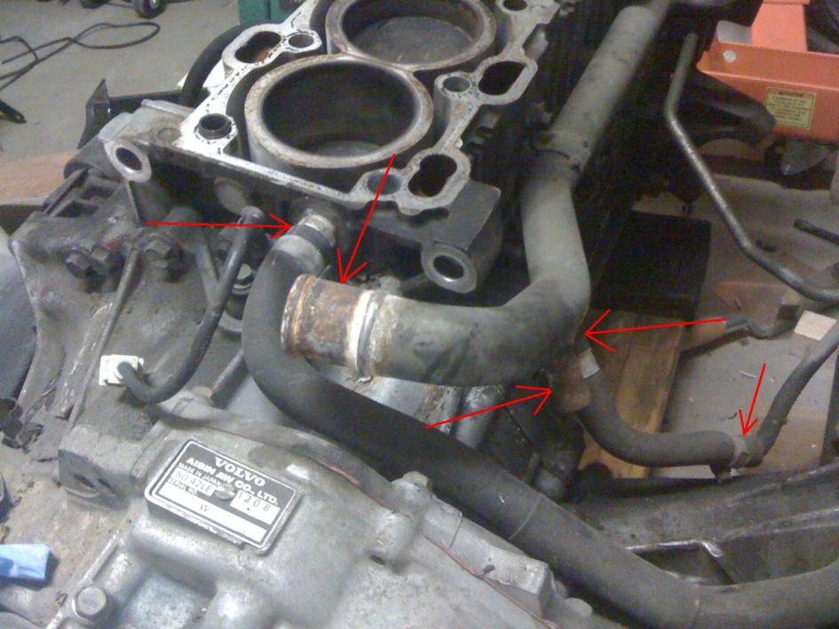

Found it. Thanks to this!
https://volvoforums.com/forum/attach...k-img_0758-jpg
Thanks Boxpin!

What did you find? All of that stuff is on the drivers side.

It was a hose clamp not tightened enough on the "A" hose on this diagram:
http://www.ipdusa.com/uploads/images...lsize_2080.jpg
It didnt leak when sitting but while running it was spitting out pretty good. About a half turn on the clamp did the trick!
Thanks for everything!
