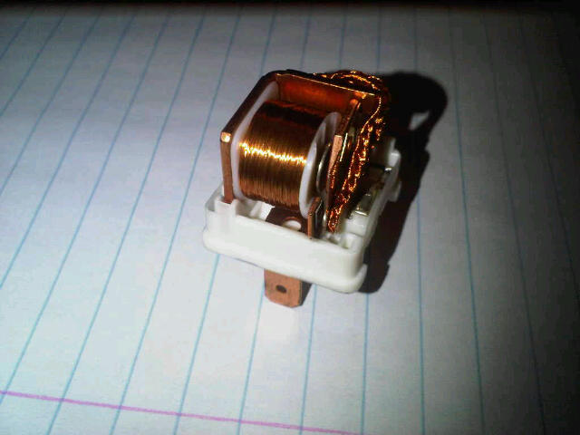

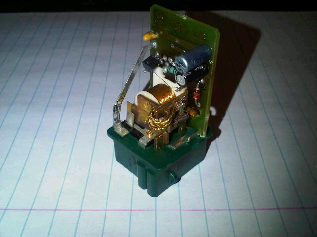

However - My main point was the fuel pump relay in the 850 is that it isn't a simple relay (see attached relay1.jpg), it is a CMOS Pulse Width Controlled Switch (see attached fprelay1.jpg & fprelay2.jpg), that's what all those extra bits and pieces are.
With a simple relay they works or they don't. CMOS switches can do all sorts of interesting things as they fail. I keep a spare fuel pump relay for my 850 in my garage (cause its a whole lot cheaper than keeping a spare pump).
