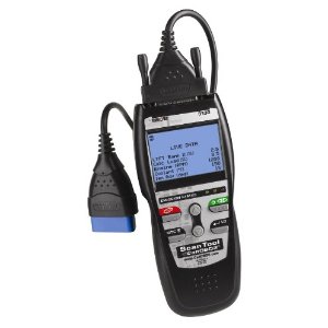

Yeah, I have this one. It is very handy diagnostic tool. These have their limitations; you must remember that what you're seeing as output data, is at best a low resolution digital sample of an analog signal, especially for trying to monitor the sensor when conditions are rapidly changing, like viewing the O2 sensor during acceleration.
That being said, I don't go anywhere without it. I have used it more than once to help diagnose odd problems that did not set a code.

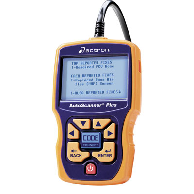

I have an Innova too
But I would reconsider that if I could have picked up one of the Actron CP9580 units because they have a built in "it could be this or that" library built into the unit so it's a bit handier doing diag in the field where you don't have access to a computer to do research on the codes.
It's sold under a couple of different names.

Both those scanners look great. They have really come down in price the last few years. I'm a cheapskate though. I ordered one of those $20 Bluetooth ones that connects to my Android. I wanted something that could plot my O2 voltages and this claims it can do it.
I'll let you know how it works or doesn't work out.
