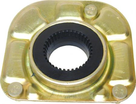

At some point that clunking will get bad enough that something is going to come apart. Part of the upper mount is a chunk of rubber with a metal sleeve molded into it that the strut goes through. If it gets bad enough the strut can pop through the mount and into the hood

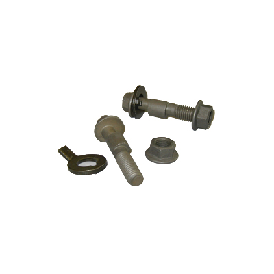

The bolts are for adjusting camber. If yours is off and they haven't been put in yet don't be surprised if they are needed.
Attached Thumbnails Spring seat--need to do both sides?-suspension-front-strut-mount.jpg   Spring seat--need to do both sides?-suspension-front-coil-spring-seat.jpg   Spring seat--need to do both sides?-suspension-camber-adj-bolts-81250.jpg
