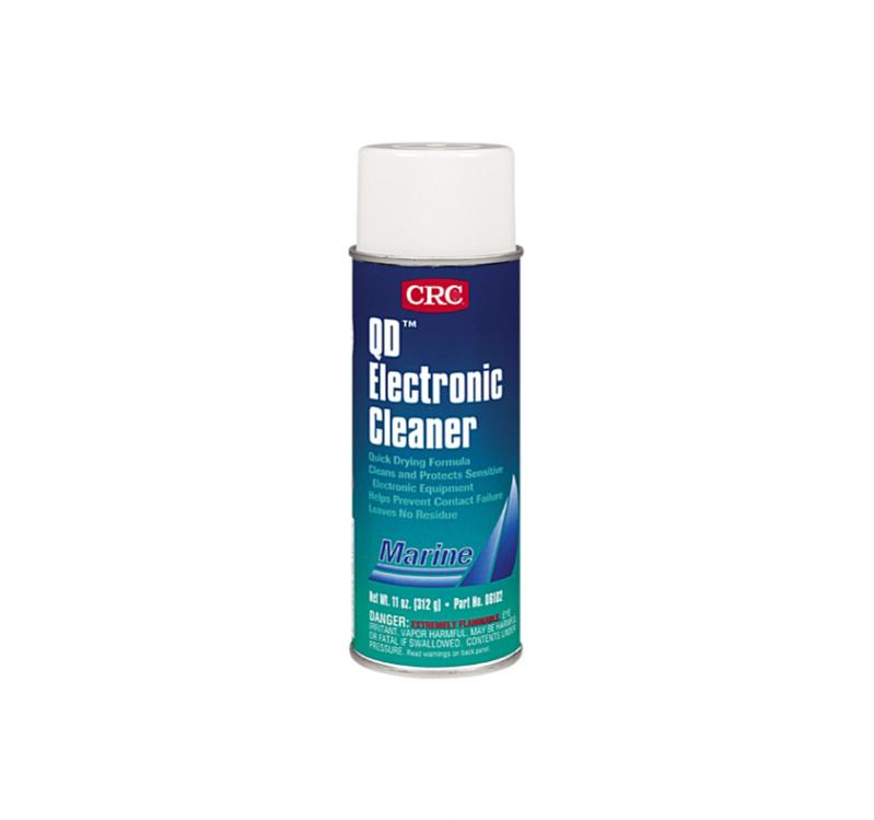

After doing a search, looks like Caig Deoxit, or CRC contact cleaner/ RadioShack to buy. Would I just pull the volume **** off then spray cleaner in and q-tip components etc? Thanks.
Old Feb 10, 2013 | 10:14 PM
Any auto parts store will carry electronic or contact cleaner.
Attached Thumbnails Stero How to fix Scratchy head unit? Clean tips?-electronic-cleaner-3m.jpg   Stero How to fix Scratchy head unit? Clean tips?-electronic-cleaner-crc.jpg   Stero How to fix Scratchy head unit? Clean tips?-electronic-cleaner-qd.jpg
