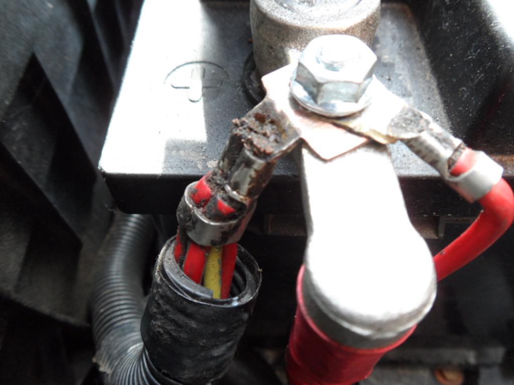

I am using a digital voltmeter to monitor voltages. The main connector connection is clean and tight. There is however a bundle of wires that are crimped on then go to the main connector, but I don't know how I would clean out that bundle.
here is a pic. Txs for your help.

I would measure the voltage output at the alternator. Make sure those connections are clean as well. I would actually take all of the connections apart and clean between the wires, etc where they bolt together. Then spray them or whatever you do to protect them from moisture.
These cars have issues with power wires, some have to replace the entire supply cables.
