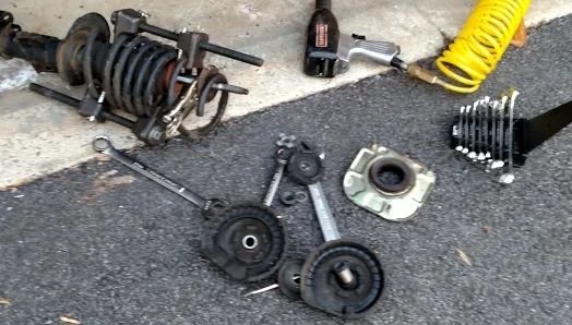

Old Jul 31, 2018 | 04:26 PM
Likes: 541
What's so hard about using "death sticks" :-) ? The common fault with the 850s is the spring seat (see pic) not so much the strut. OEM is Sach Boge which can be found for $90 per strut, then you'd want to use OEM or better for the seat - otherwise you'd probably get to do the job again in another 50-60K miles. Add the replacement spring seat - $50 for Genuine Volvo or $40 for the IPD Heavy duty seat (a good upgrade) and your parts will total up to about $175 per side. Looking around, I see eeuroparts sells a complete assembly (Swedish Pro Parts brand - not sure of their reputation) for $200. Given the price includes a spring, you can bet they are not using top shelf parts. My two cents is to go with the OEM struts, the HD seat and have a friendly Indy shop install and do the alignment for you. I'd guess about 1-1.5 hours book time per side so you'd be in for $700-750 total for a good as new ride. Personally I like to do the work for myself since I can also inspect other bits that may need replacing like the sway bar bushings/.end links which can also cause clunks over bumps. If you are planning to sell the car in the next year or so and plan on doing the work yourself, you will still be in for $500.

Originally Posted by rspi
I've done a lot of front strut parts, sad to say, one good NE pot hole will take out the best spring seat. However, you have a 75% better chance with Volvo or Bilstien parts.
Wonder how would my camber plate handles those pot holes. Oh well, I sold my Volvo so I guess I'll never find out.

Well I bought a spring compressor and removed the struts with no problem. The strut is hard to push in and pull out but I bought a pair KYB struts for $164.00. I cant tell why the spring seat would be replaced.It looks good as far as I can tell although it is very hard. The strut mount bearings spin freely without any gritty or grinding sound. All the nuts and bolts are good along with strut mount washers.The bump stops are completely gone just crumbs. Are the spring seats supposed to be soft? Should I get new strut mounts anyway?
Old Aug 10, 2018 | 04:36 PM
  #18
firebirdparts's Avatar
Joined: May 2012
Posts: 1,988
Likes: 52
From: Kingsport, TN
The spring seats only last until that little piece of pipe comes out of them. Then they're no good. They aren't really soft, as they hold up the weight of the car.
