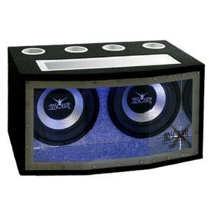

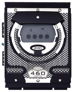

Old Dec 15, 2011 | 02:50 AM
If it wasn't on clearance I didn't buy it. It does have base though !!
1 X AM/FM/CD/USB
2 X Jensen A46XP 2 chl amps - bridged mono 115 watts one L / one R
1 X DAB4754 4 Chl amp - Subs only, bridged to 2 channel 250 watts per
4 X Speaker boxes 6.5" mid and tweeter
2 X sub boxes 2 X 12" ea
Plus car speakers
