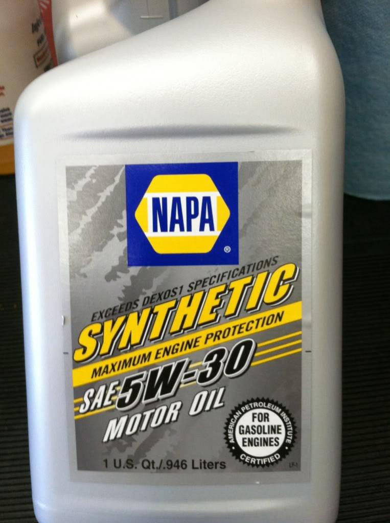

"as long as you run Castrol or Mobil1(preferably Castrol) you're fine."
And what's wrong with the rest of the synthetics or what is so good with just those two ?? I like Valvoline myself but for no particular reason and I'm not above grabbing a "house" (Autozone, Oreilly, Napa, Walmart) brand when they have a good sale on it. If you can't afford Mobile1 the house brands are still better than the blends or conventional
Attached Thumbnails Thoughts on using diesel oil.-oil-oreilly-synthetic.jpg   Thoughts on using diesel oil.-oil-royal-purple-syn-5w30.jpg   Thoughts on using diesel oil.-oil-valvoline-5w40-syn.jpg   Thoughts on using diesel oil.-oil-napa-syn-5w30.jpg

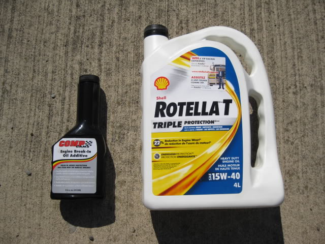

Depending on the diesel oil, it could be better if it still has zink in it. That's one of the "pollutants" they pulled from regular oil and it's hard on lifters and cams without it. You can buy it separately for "break in" or just add it to high performance engines at the change interval. Depends on your cam geometry, the more radical the more it can help protect your valve train.
I've run diesel oil in both my 850 turbo and 454 Chev Madza.
