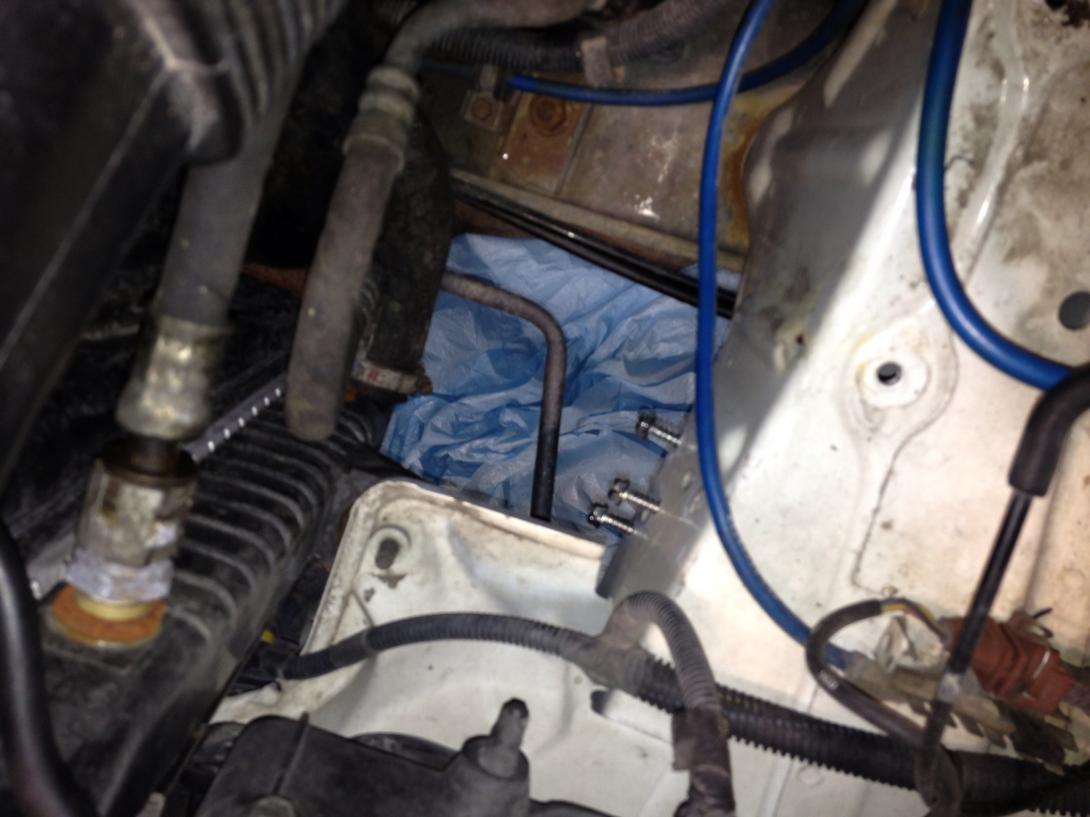

Remove battery and tray. Drill 3 holes for the filter mount. I have been using a right angle drill btw. I actually drilled the holes from underneath the car.
Old Jul 4, 2013 | 04:18 PM
ffmeltdown's Avatar
Joined: Aug 2010
Posts: 38
From: kcmo
Underside view.
