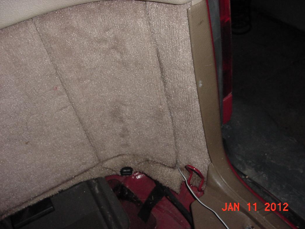

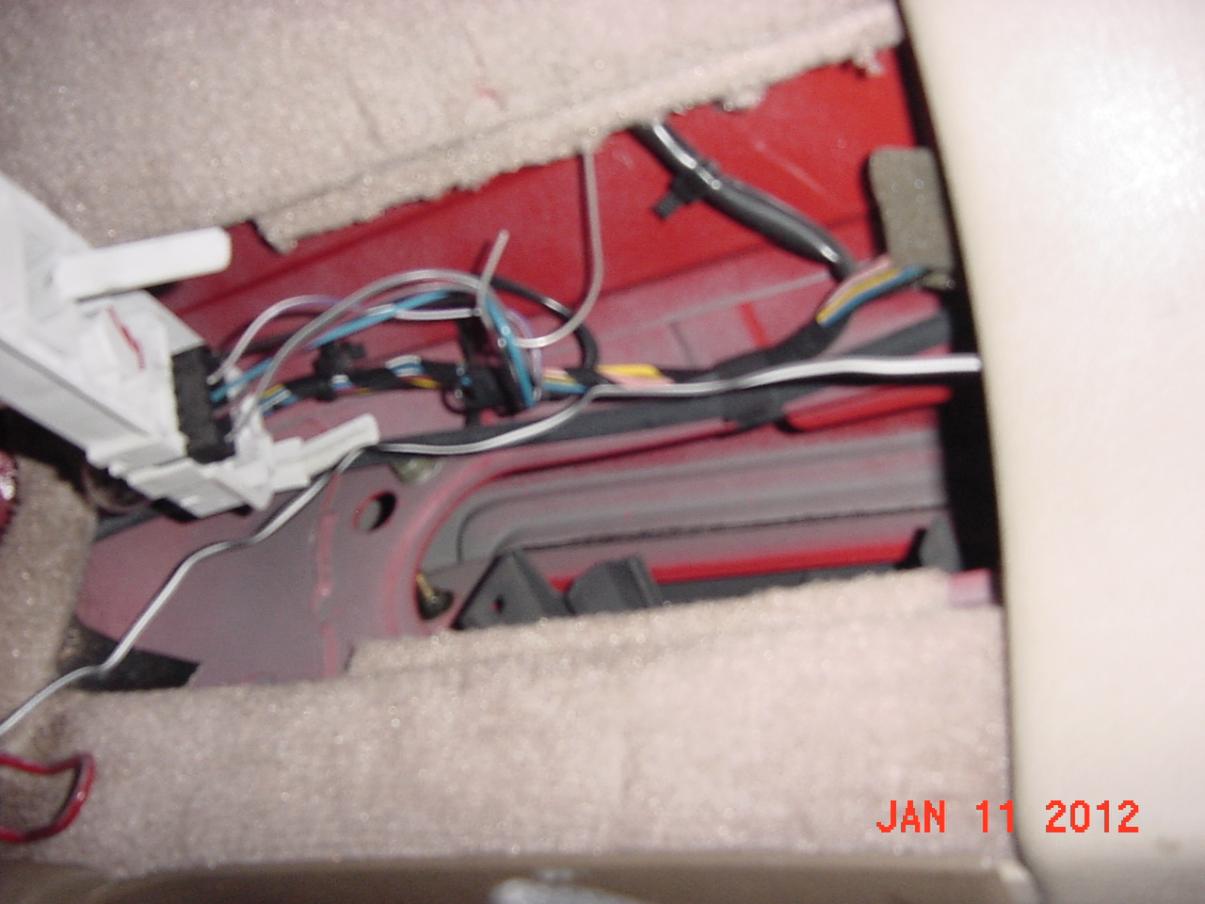

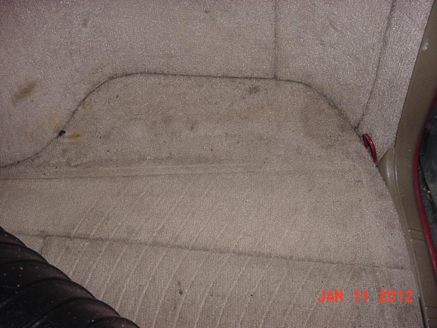

This should do the trick.
http://www.matthewsvolvosite.com/for...hp?f=9&t=17734
Attached Thumbnails Transmission Issue and Taillight Replacement-dsc01094.jpg   Transmission Issue and Taillight Replacement-dsc01095.jpg   Transmission Issue and Taillight Replacement-dsc01096.jpg   Transmission Issue and Taillight Replacement-dsc01097.jpg   Transmission Issue and Taillight Replacement-dsc01098.jpg
Old Jan 11, 2012 | 08:22 PM
You pull up the floor board, turn the black **** at the bottom of the corner carpeted piece and either reach in there and get the upper nut with a wrench or you'll need to pull out that plastic trim piece between the speaker and the carpeted corner piece you just removed.
