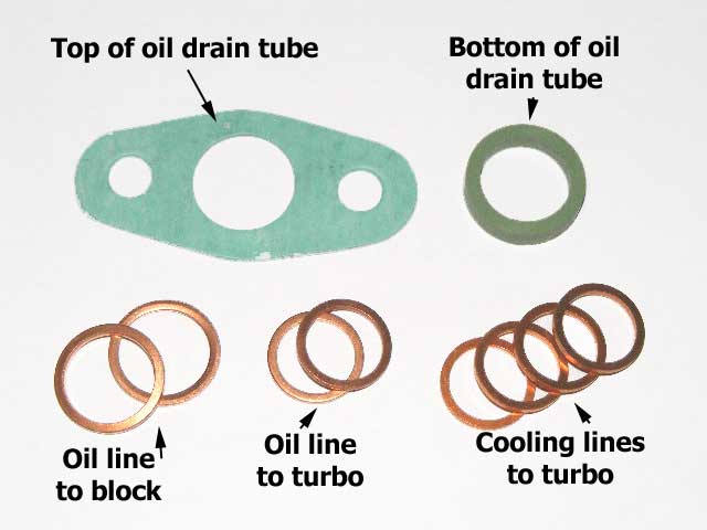

The kit should consist of these parts and is everything you need for a normal rebuild.
Have you done one or have you read full instructions on rebuilding one ??
TD04HL Turbo rebuild kit (Super back)
http://dproberts.files.wordpress.com...ild_manual.pdf
There is also youtube.
Are you aware what a superback is ??
You want to pay attention to the part of the instructions on marking the wheel for reassembly or know where and how much $$$ you'll spend on balancing.
You also want to have the info off the data plate on the turbo so know exactly what turbo you have.
On the "oil drain tube to block" O ring, seal or whatever you want to call it, get the green one if possible. A number of people complain the basic black one doesn't hold up well but the green ones do.

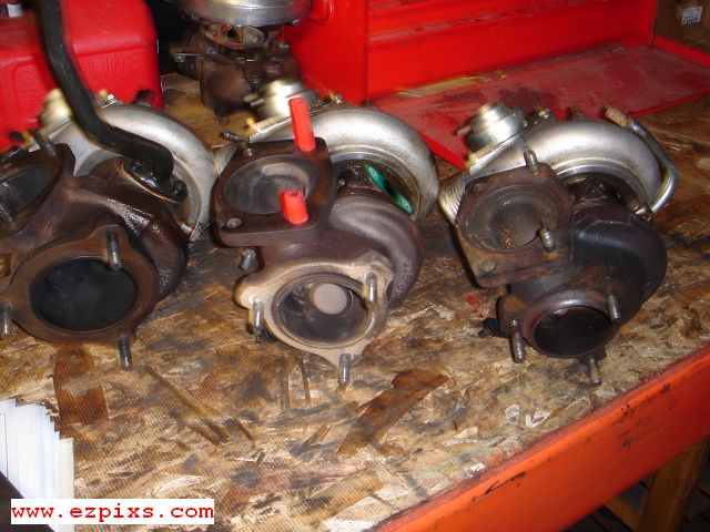

Then if you're going to rebuild you should try to get rid of the conical exhaust housing. It's the most restrictive and it's the only one that is "conical" in shape and none of the aftermarket performance exhausts or downpipes will fit it. They all come to fit either the straight or angled.
This is NOT a consideration if you're just doing a rebuild and intend on keeping the exhaust stock.

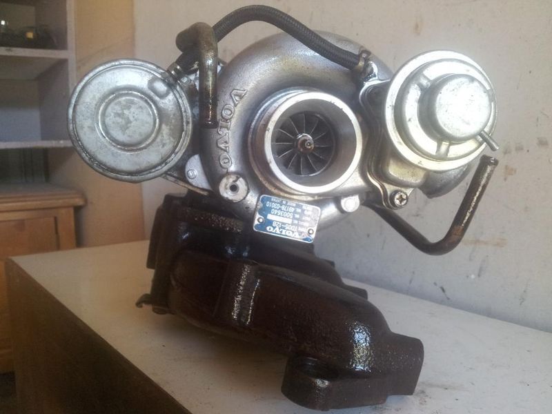

It seems as tho the turbo in my 850 AWD (13t if I'm not mistaken) has packed it in. I'm getting oil leaking out of my intercooler, very little boost and a generally ****ty attitude from my engine. There is an S70 in the local wreckers that I'm considering for a turbo donor, how can I go about checking the VIN to see if it is also a 13t?

What year 850 AWD ??? What year S70 ??? The fact you're asking what fits what should make you sensitive to the fact that the parts change and you need to be more specific about what you're asking.
On an older car you need to check the turbo itself. The VIN will tell you what it came from the factory with but won't tell you what is presently on it. It's likely to be stock but there are a number of us that have upgraded our turbos. Someone thinking it's a 15 with a conical would be surprised to find a 19s inducer under the aftermarket intake side with an angled exhaust housing. You need to read the numbers off the turbo ID tag itself to be sure what it is you have.
The downpipe can be picked up off ebay in stainless steel for around 150 bucks. People who buy the OBD system get both a straight and angled downpipe so they usually toss the extra one up on line to make some $$$
The 95 turbo has a different turbo housing fitting called conical because it is like a ball. The other two more common ones are straight and angled. Both are bigger and flow more air easier then the conical.
The exhaust housings are interchangeable.
Attached Thumbnails Turbocharger Question-turbo-id-plate.jpg   Turbocharger Question-turbo-loose-shaft.jpg   Turbocharger Question-turbo-outlet-flanges-angled-straight-conical.jpg   Turbocharger Question-exhaust-obx-stainless-steel-full-turbo-back.jpg

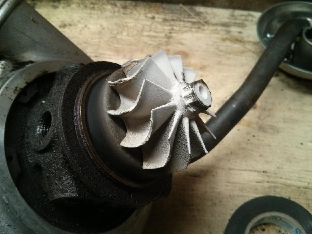

Half the turbo came out this evening.
I suppose there isn't normally scale built up on the turbine like that, and has probably made the whole deal very unballanced.
There is some up/down play in the shaft. Also, looks like the factory 13G turbo based on the name plate, and is the 'superback' style as previously mentioned.

That can definately cause a bit of an unbalance and make the bearings go out sooner than they should.
