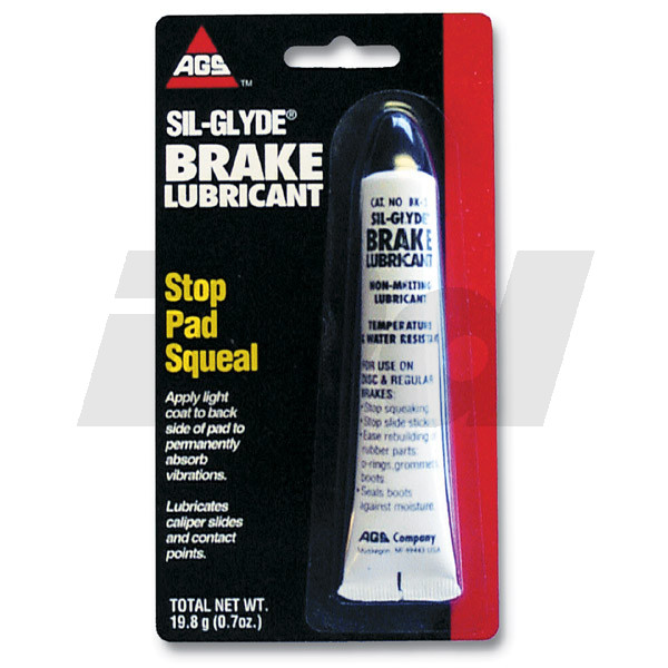

what about this stuff? anyone try it?

All this being said, above has really very little to do with your problem, which is brake squeal. Like Tech said, try the pad shims; might also try the anti-squeal grease on those as well; it may help.
But more than likely they're just cheapo pads on there now, and/or were never seated in properly when new, so they will just squeal no matter what. If that's the case it may be time for new (quality) pads.

Get the half shims and that should fix it.
