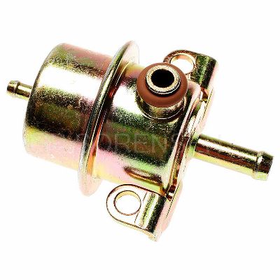

Old Mar 6, 2012 | 08:54 AM
If you're looking for reasons for tripping an engine rich code you should also take a look at the fuel pressure regulator vacuum line. If the diaphragm inside the regulator ruptures then the vacuum line will draw raw fuel into the intake. Take the vacuum line off the regulator and see if you notice or smell gas. Also look at the nipple of the regulator where the vacuum hose attaches to see if it's wet. If you notice the sight or smell of any gas then the regulators diaphragm has failed and needs to be replaced.
It's one of those things that can be easily overlooked.

Thanks, I check the regulator next. Air filter is good.

Regulator seems good, no leaks.
Before, the engine made slightly different sound after startup for a while. I think it has something to do with evap-system. Now I don't hear that sound. Does this thing in the picture have something to do with it or what is this ?
