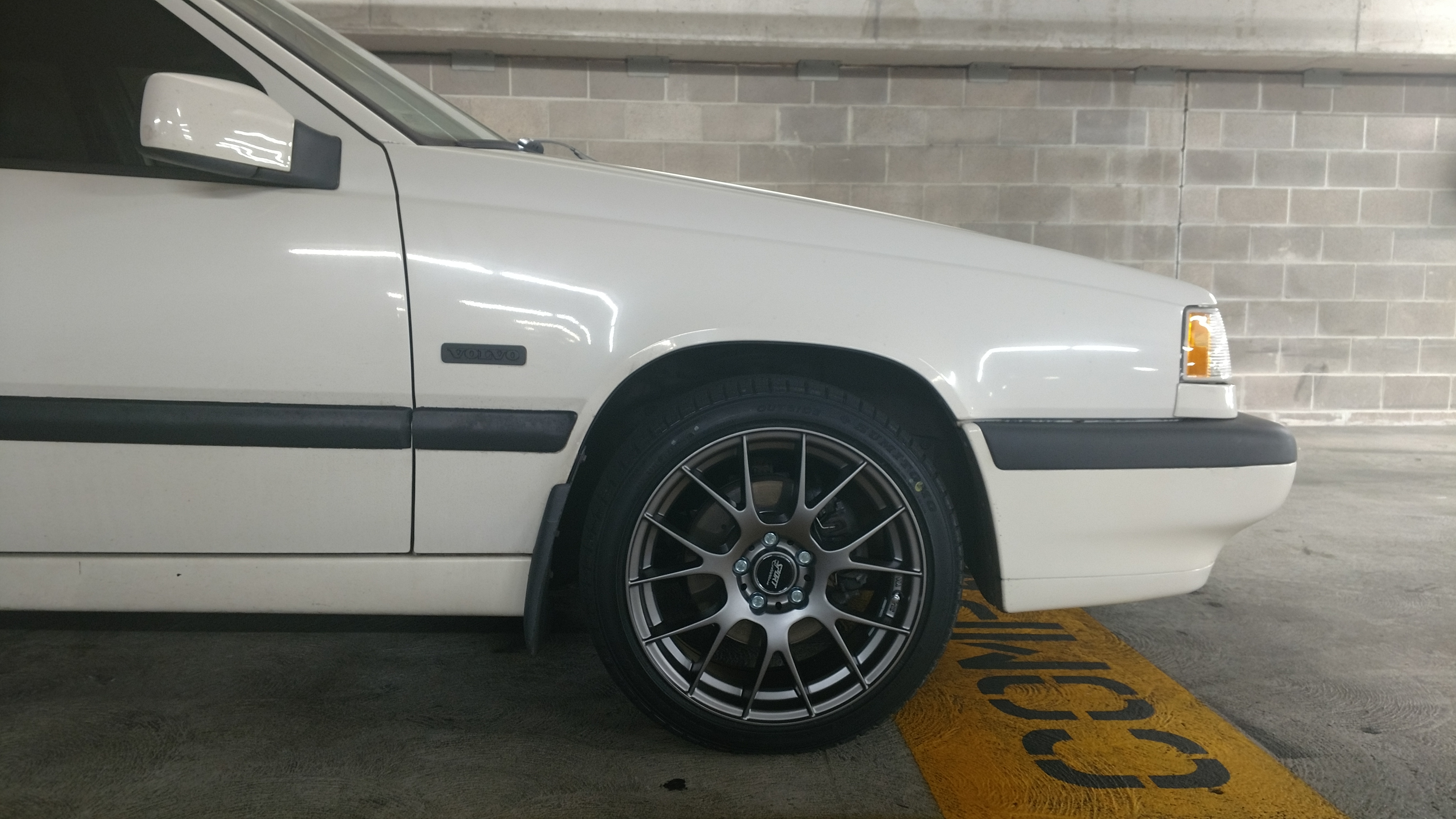

Default New Shoes for Sven
my new shoes arrived last night. 17x7.5 Sport Edition SE-16s. Sumitomo HTR A/S PO2 205/45R-17.
the ride is a bit smoother but the handling is vastly improved. i'm betting my mpg will improve by 1 or 2 as well.
ordered from TireRack - arrived w/in 3 biz days and were in great shape.
Attached Thumbnails Upgrading Wheels & Tires-sven-shoes.jpg   Upgrading Wheels & Tires-sven-shoe-close.jpg

Looks good
Bit off topic, but is it possible to get 17's under the car if its on IPD lowering springs and yellow Koni's without running into clearance/rubbing issues (especially over bumps/potholes)?

That looks amazing.

Likes: 540
thanks for the pics of the wheels. Looks great! 97-850Wagon, fitting 17s is more about choosing the right rim width and the right offset. If you go with 7x17 ET40 with the 205/45-17s you should be ok. Generally lowering springs are firmer so they have less travel for the same weight. Most clearance concerns are with rubbing on the strut (wrong offset) or rubbing on the fender lip (too wide a rim/tire) on lock to lock turns, not when you crush the spring to the bump stop...
