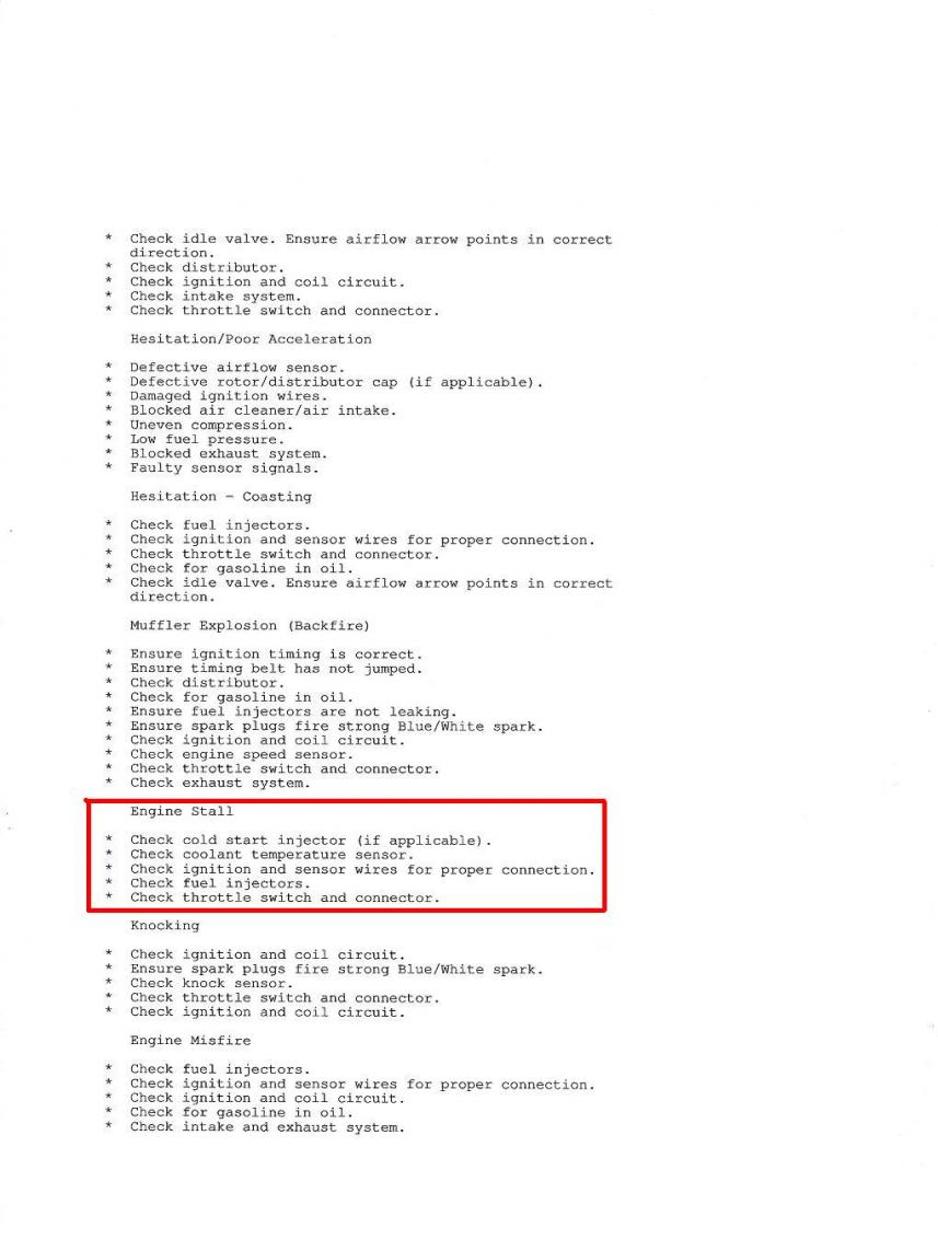

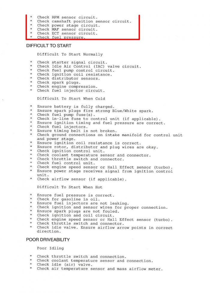

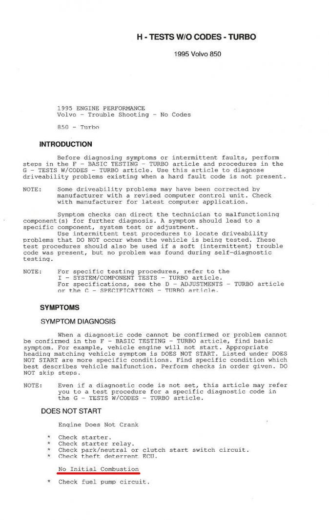

I would like to know what brand of battery you've installed.
I would also pull codes to see what is giving you the trouble.
How old is your alternator? The average life of the Bosch OEM alternator seems to be approx 10-12 years/120,000-140,000 miles.
No-start/engine quitting during cruise can be due to a number of reasons:
- Faulty fuel pump
- Faulty fuel pump relay
- Faulty CPS (Cam Position Sensor)
- Faulty ECT (Engine Coolant Temp) sensor
- Faulty TPS (Throttle Position Sensor)
- Etc...
Note, that when you replace a battery, the new battery must be fully charged or it could sometimes fry the alternator.
See attached FYR.
JPN
Attached Thumbnails volvo 850 engine cuts out when driving-850-turbo-drivability-problem-1-.jpg   volvo 850 engine cuts out when driving-850-turbo-drivability-problem-2-.jpg   volvo 850 engine cuts out when driving-850-turbo-drivability-problem-3-.jpg
