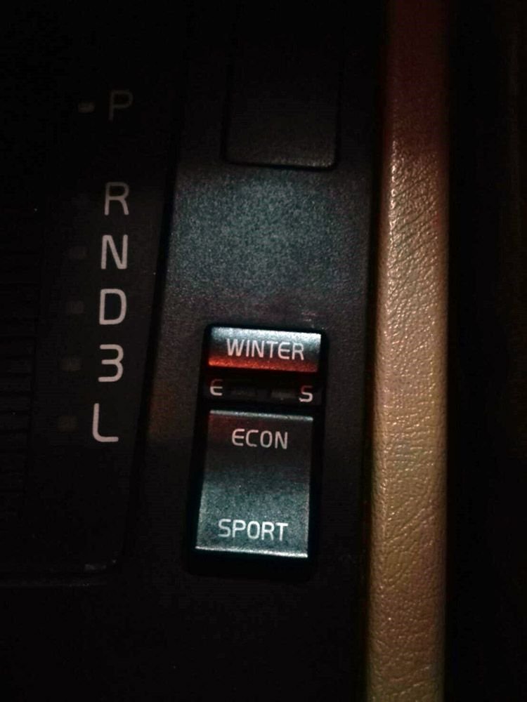

I need to replace the shock absorbers and suspension parts, and I recently had communication with a company on eBay. But when I mentioned I had a switch for 'winter - econ - sport' near the automatic gear selector, they said the standard shocks they sold wouldn't fit.
Would anyone know what shocks/suspension parts I would need to order for my car?
I've attached a photo of the switch in question.

That switch has nothing to do with suspension. Its for the transmission. All 850s have it

Note: The switch on the console changes the shift points for the transmission. winter mode starts the car in 2nd gear and lowers the shift points (not very useful in Thailand. sport mode allows the car to hold each gear longer for more performance. Econ is your normal day to day driving...
