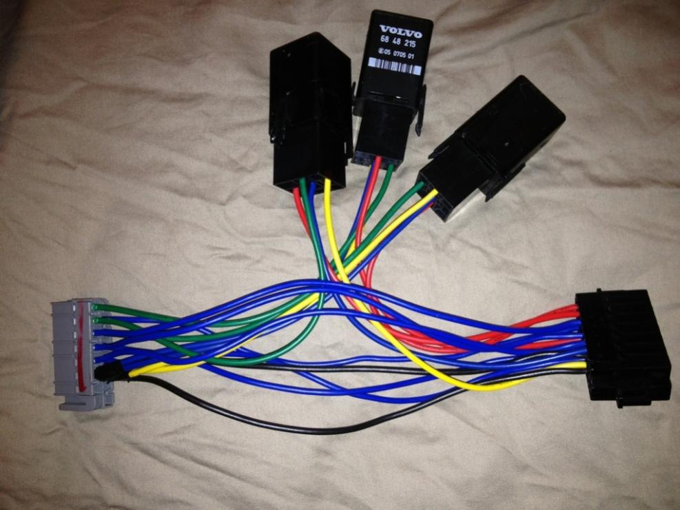

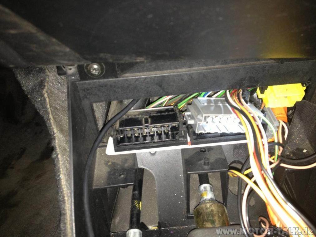

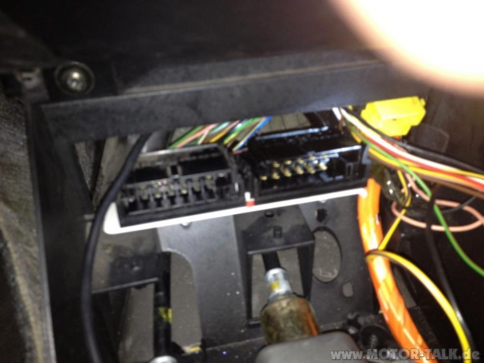

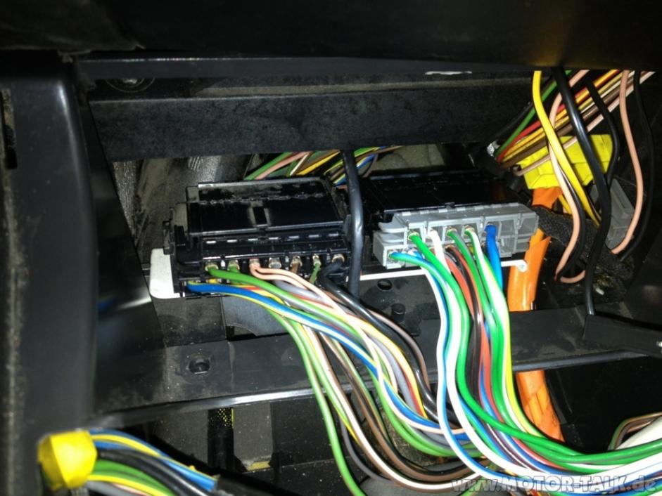

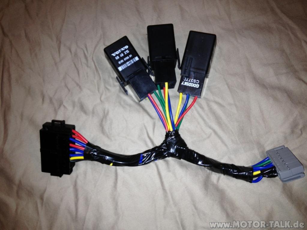

I made a small harness with 3 relay socket. In each relay I put an Auto Relay (850, S40,V40 (1st Gen), 960, S90 V90 will do). This way I have Auto Up for the driver and also Up and Down for passenger.
The harness goes between the connector from the switch assembly and the car harness.

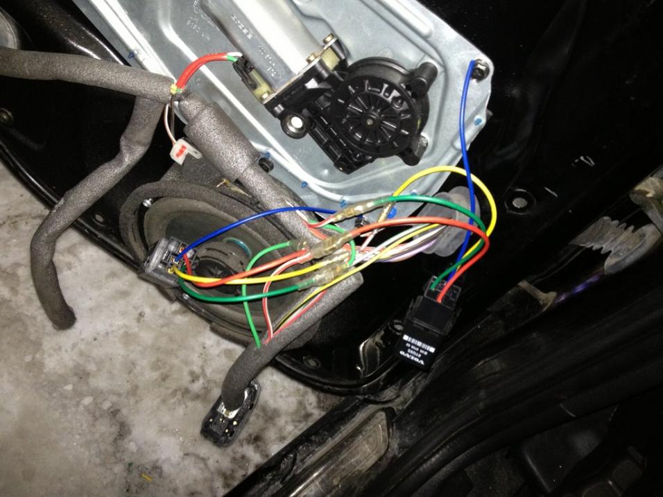

I also put in each back door two of these relais and of course added the missing LED and another "lid".

If you want the wiring diagram I can post it it is very simple. The connectors can be bought from Volvo (although only black is still available), cost around 1,50$, pins are very cheap, the sockets for the relays costed me 3$ each. Relais were part from the scrap yard, part eBay. Rear pics are from a frieds V70 where I did the "mod".
Cheers
