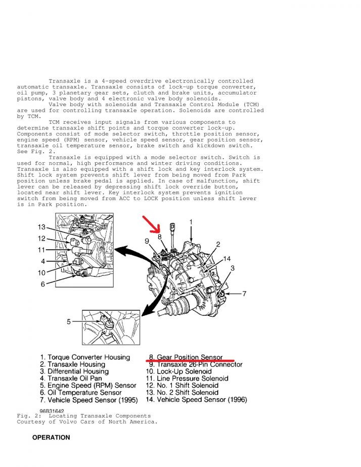

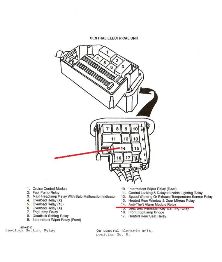

If it does not crank at all, PNP switch as mentioned or the starter went south. Also check starter (alarm) relay.
JPN
P.S, the relay configuration may differ on '93 model.
Attached Thumbnails Volvo '93, not cranking.-850-na-driveability-1-.jpg   Volvo '93, not cranking.-850-starter-ckt.jpg   Volvo '93, not cranking.-850-turbo-ceu.jpg

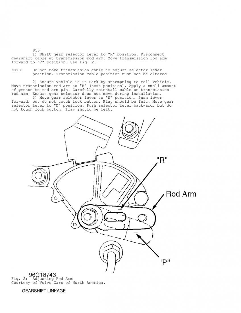

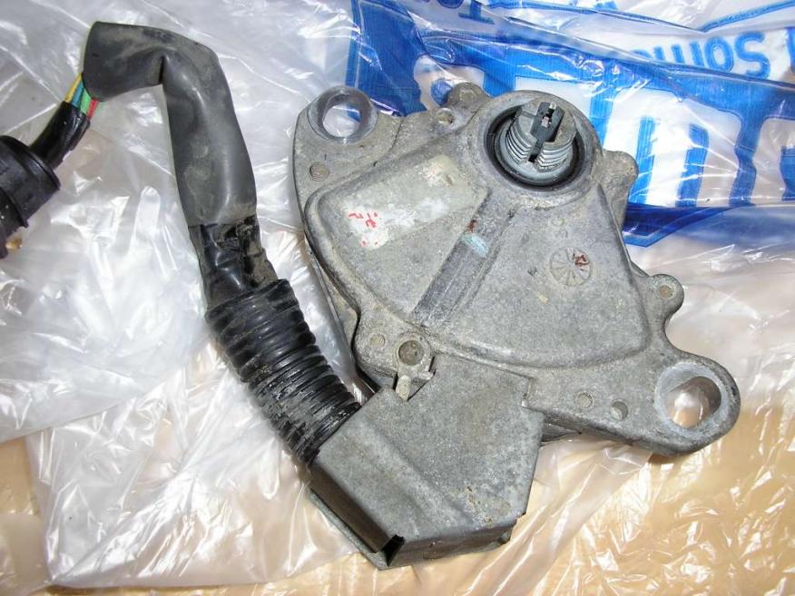

The PNP switch is located on top of the transmission housing.
If you're looking for a replacement, I would get one from FCP Groton/IPD.
JPN

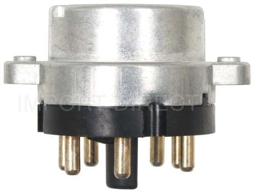

The ignition switch is right behind where you put the key to start the vehicle.
How to with photos:
http://www.matthewsvolvosite.com/for...hp?f=1&t=37398
You can purchase one at an auto parts store like NAPA, autozone .... or go to http://www.fcpgroton.com/customer_ac...y/account_info or https://www.ipdusa.com/customer_acco...rMessage=login
