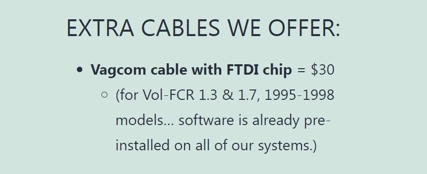

On a 1997 your blinking CCM lights mean there is a code stored - to read them (on a 1996-1998) you need Volvos scan tool from back then. I have heard of an aftermarket software solution for that problem - but I don't know what is used to interface with the ODB port.
These guys might have the scan tool answer - and a snippet from his webpage is below. https://diaglaptops.com/wp/dice-units/

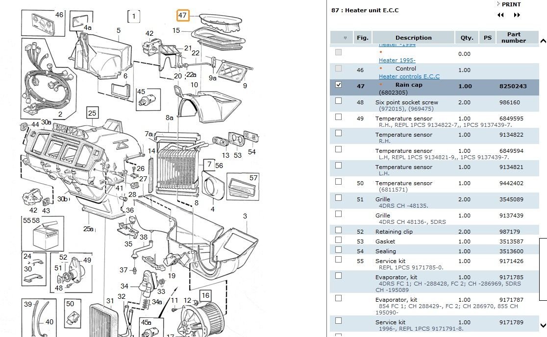

I didn't know about it. I did not remove the dashboard. You can't even look there. I took off the rubber hose that drains water from the housing through the floor outside the car. No. 38 on the diagram you received in response. Only a few drops of water fell.
I was sure something was blocking the drain. I solved it. I took a thin strong stiff wire. I put it from the side of the floor where I took off the rubber hose and I wanted to take it out after a while but it was blocked. I will use more strength. And slowly I pulled the screw from the fan housing. The head of which perfectly blocked the flow of water. I hope it helps you. Let me know if it worked. Adam.
