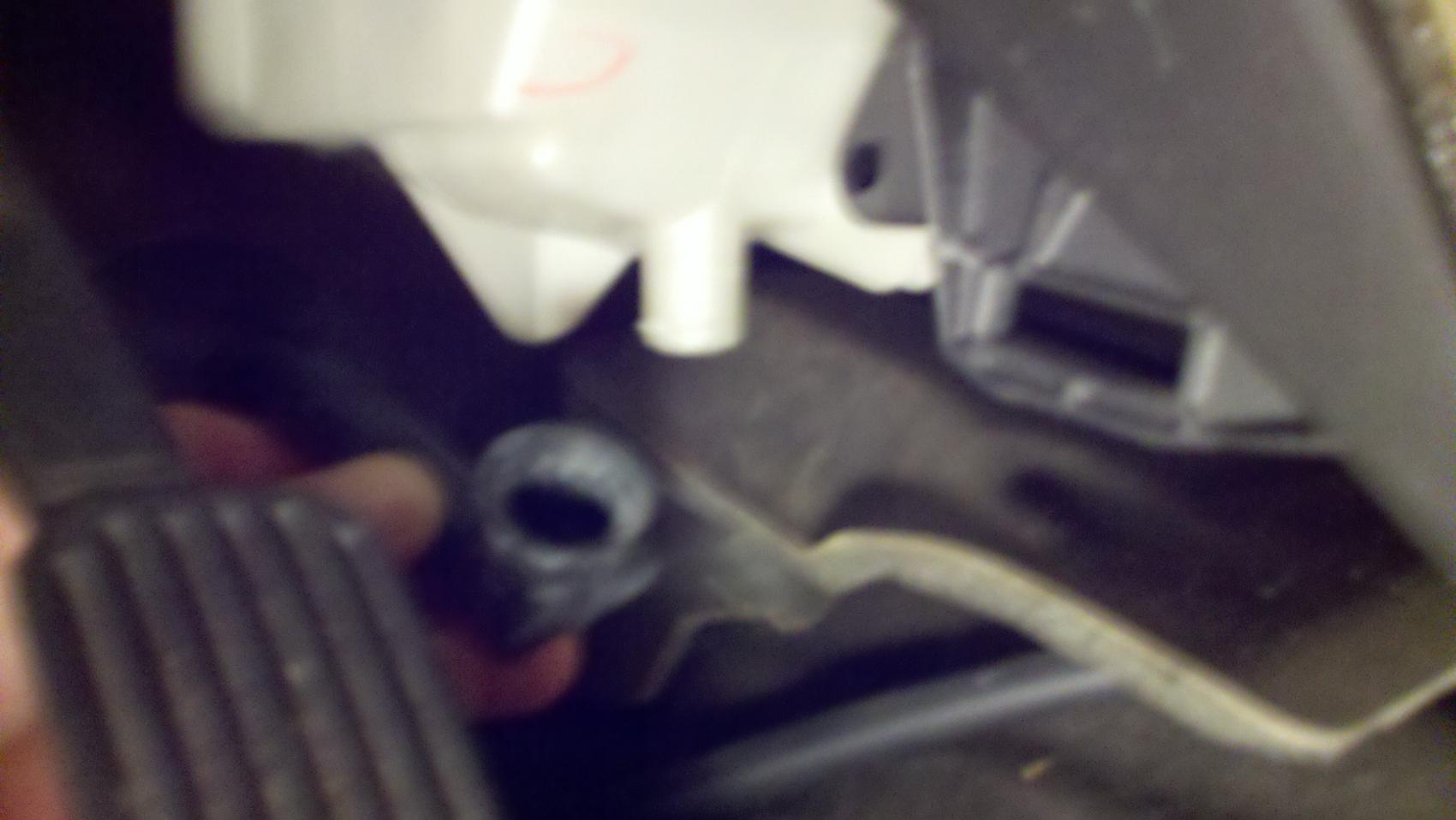

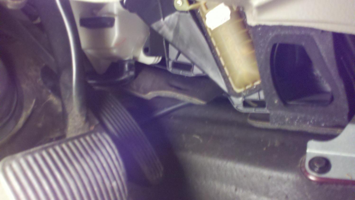

Ok I tried one more thing. Removed 2 plastic panels by your feet. removed the rubber ac drip tibe and blew compressed air into both the tube and the ac unit and nothing happened. The water still does not come out
I checked it while the ac was on with the tube removed and just cold air blows out into that tube. I feel the next step is removing the fu***ng dash and tearing everything apart. I am posting pics(cellphone pics so they suck sry). I know someone out there knows what to do here.

Ok I found another volvo tech. He told me the tube I was looking at on the drivers side was the wrong one that one was for the heater core. My evaporator drain tube is on the passenger side. I told him I am not getting water on the passenger side just the fornt drivers side. He told me that it dosent matter the water can come from anywhere, like taking a hard left turn would do that or parking on a hill.
So I located the evap drain tube on the passenger side. I removed it blew compressed air into the end of the tube and No water came rushing out and I still have the same problem.
