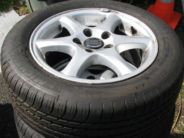

Will these wheels fit an 850? I think they are a newer model but the bolt pattern looks the same? The tires are 195/60/15.

Should

If bolt pattern is 5 x 108 (which almost all Volvo wheels are) and the offset is around 40mm (which it probably is, although it will be stamped on the back of the wheel) then they will fit.
