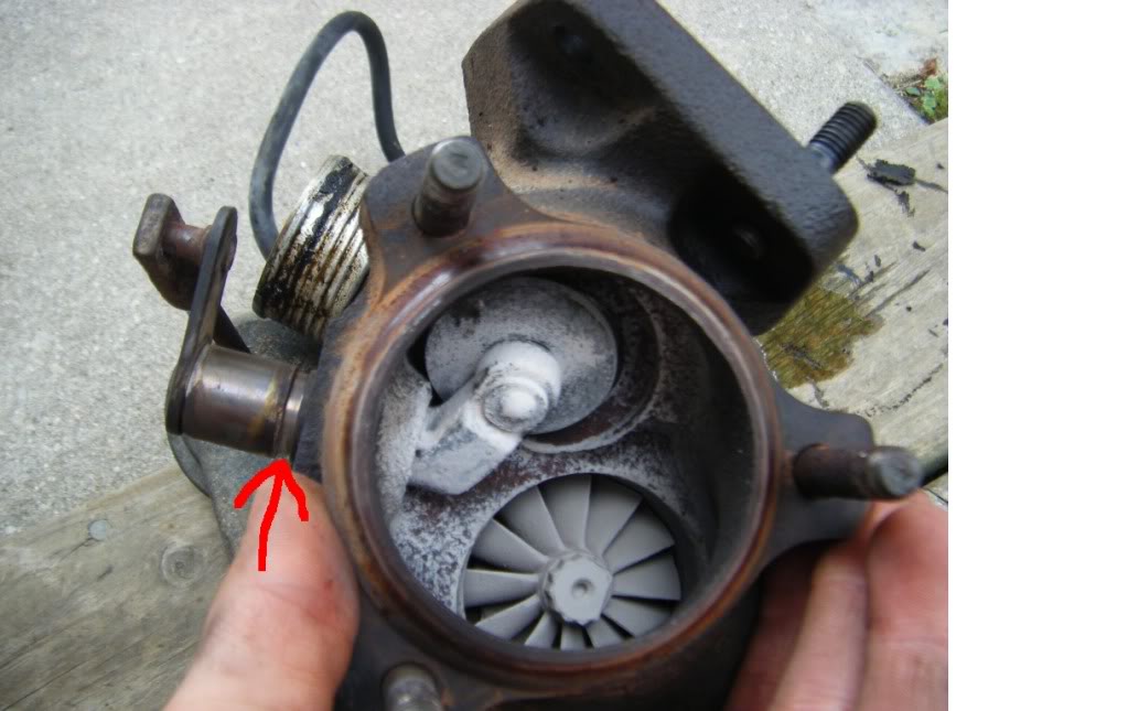

So just bought a 96 850 turbo, but in order to pass emissions i need to replace the wastegate which is causing engine codes for the 02 sensor and MASS. Now my problem is i have not been able to find parts anywhere. Also i am wondering if the entire turbo could have been blown if the previous owner was running around without the wastegate working properly? Is there any way to test this, or even test the wastegate to assure this is the issue?

The wastgate on these cars is internal, unless its cracked or missing it will function. You need to do a pressure test on the waste gate acuator to ensure the actuator is working properly. Ive never heard of the actual waste gate going bad.

The wastegate is controlled by a vacuum diaphram which gets vacuum from a solenoid controlled by the engine management computer. Volvo refers to it as a BCS, boost control solenoid.
If you are setting a BCS code you may have a bad BCS but that doesn't indicate any wastegate physical problem only that the vacuum actuator isn't getting the right amount of vacuum and the solenoid might need to be replaced.
The purpose of the wastegate is to control the maximum pressure the turbo can build. It's not connected in any way to the functioning of the O2 or MAF sensors. It simply sends exhaust gas past the turbo instead of spinning it even faster. It's built into the turbos exhaust housing.
There is a procedure to test or set the wastegate. You apply a specific amount of vacuum to the wastegates diaphragm and adjust the linkage accordingly.
To replace the wastegate you would need to replace the exhaust housing of the turbo or are you talking about the vacuum actuator for the wastegate which is external and unbolts ?
