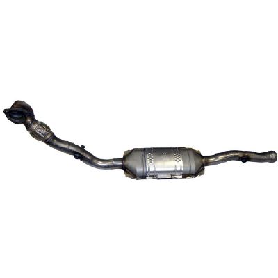

What he said. Only addition would be if the downpipe is aftermarket and shiny or chromed looking. Then it's likely an aftermarket stainless steel part.
Cast iron manifold, stock steel downpipe with cat and aftermarket stainless steel system.
Attached Thumbnails Volvo Downpipe material, what it is?-exhaust-manifold-r-30637921.jpg   Volvo Downpipe material, what it is?-exhaust-cat-stock.jpg   Volvo Downpipe material, what it is?-exhaust-obx-stainless-steel-full-turbo-back.jpg

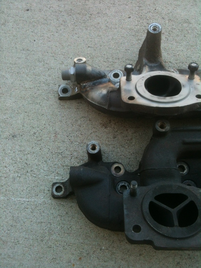

Here is an EGR port welded to an 'R' manifold.
