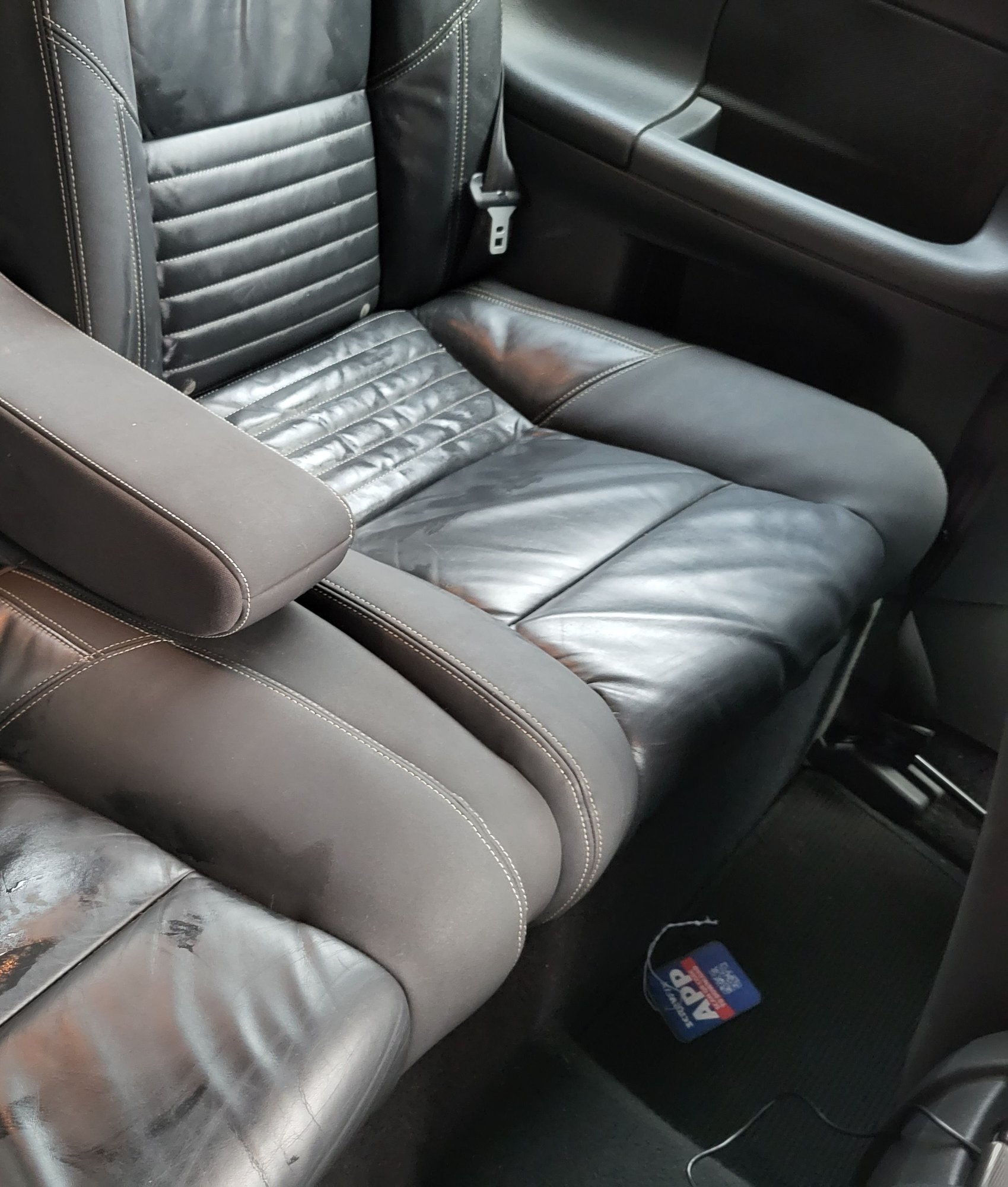

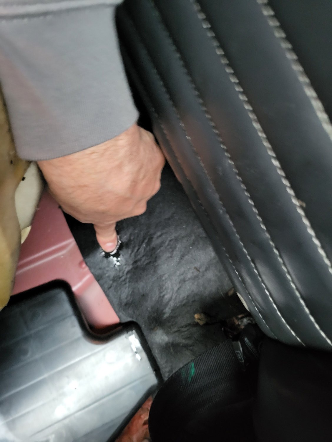

Can anyone please help, i have water under the back seats, causing mold. I have attached photo's. Could it be the plastic things? Is i im not sure what they are. Any help will be greatly appreciated. Thanks.

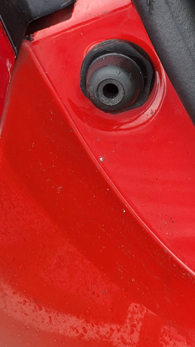

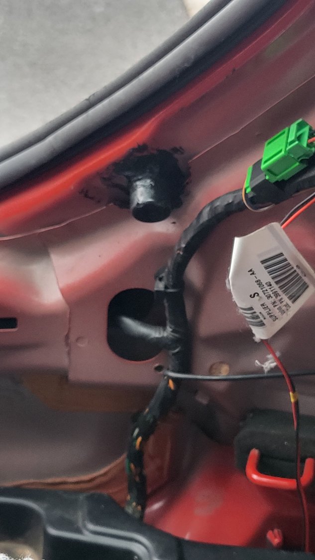

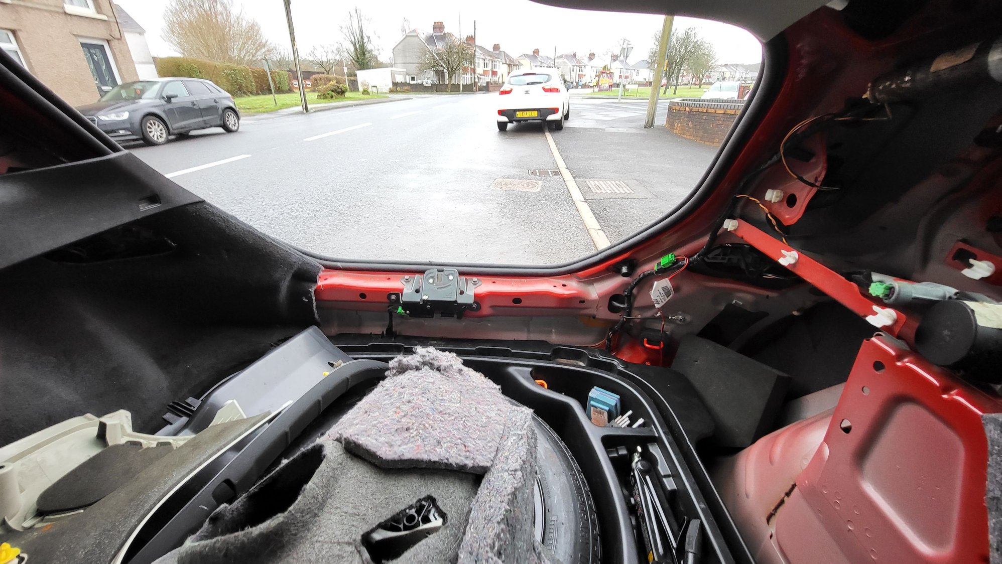

Default Update I found the leak
UPDATE***
The leak was in the boot stoppers. I stripped the boot internal panels off and put a hose on the roof and the water was pouring in for the boot stops. I sealed this up and now no water. *see photos​​​​​​​
