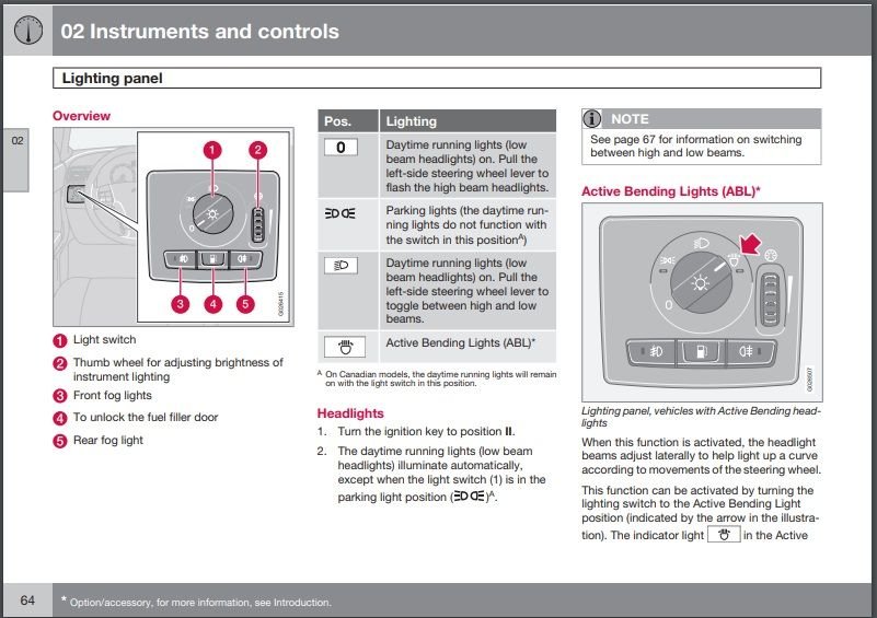

That far right location I have/2012-2013 is for I believe called the Adaptive Headlight Feature.
The headlights move in the direction you turn steering wheel. Ideal for mountain curves.

Originally Posted by anacortesian
I did not know that Volvo had developed a moving headlight position-in-relation to road direction for the car.
In Cars with Active Bending Lights the switch looks like below. And headlights in Canada are required to be on all the time also - there is no off switch. Many Volvos in the US can have the daytime running lamps turned off (the low beams on most cars pre 2015) - so the lights are off in the off position (when the car is running). This is done using a command with VIDA. I don't see that option in the CEM for a 2012 c30.

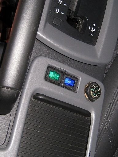

Got your console dismantled? So you might want to consider doing what I did to transform that outdated "toll road coin tray" into something more useful. I used simple rocker switches that light up when switched on (found on ebay). After you cut-out the "tray" in the console...You will need to fashion a flange to seat the switches into the console. I used a piece of black sturdy 1/8" inch plastic that I carefully measured and cut with an Xacto knife so it would just "pop-in" and still remain totally removable. I wired the green switch (finding power from under the console with any "hot" red wire) and a ground to the green switch, to be a simple reminder to me that when switched to the on position, I'm using my "daytime" park lights (which is the 2nd position on the light switch) instead of just burning up my "Factory Swedish daytime driving lights (lightswitch left in the usual off position). Since I live in Southern California I do not need daytime driving lights. So I simply switch my dash light switch to the park light position during day...BUT...I needed a reminder to shut off the main light switch when I parked the car (or it's AAA time, or whoever, to jump a dead battery). and that would be a very bad day...and we don't want that. The other (blue switch) is for aftermarket fog lamps that I added up front (my car came without the factory fog lamp option). The switch tells me that my fog lamps are still lit when I shut off the key. And my "alt power plug" that you see on the 12V factory console receptacle next to the switches is just another of my "usefull adaptations" to the console. It's totally removable to use the receptacle ...I just stuck a small compass into it (instead of the plain black factory cap) so when not in use, it too would have some type of an useful function...other than just a weird black plastic cap-on-the-console.

My drls work when switched to the A setting.
Will ID which setting controls the Active Bends once dark hits. The option is definitely setup on this car.

My Active Bending Lights also function via the A headlight position. 😅
