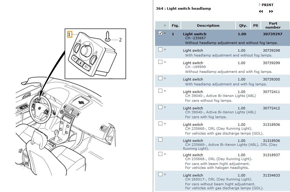

New to Volvo and not familiar with at all. Questions are should the left fog cut off when switching to bright? Are all the headlight switches the same? I see some that the left fog button is different. Lastly should the fogs be on constantly? Someone changed bulbs and something doesnt seem right. Any help appreciated

Volvos are originally wired for front fog lights with low beams only. Looks like some cars don't have front fog lights so there won't be a push button switch for them of the left of the switch. Rear fog light switch is on the right of the gas door release.

The left side push button does nothing. The indicator lights up on the right side. Im gonna put a switch in it just to see if anything changes. The car has a low beam message on but the bulbs are good. Thanks for the info
