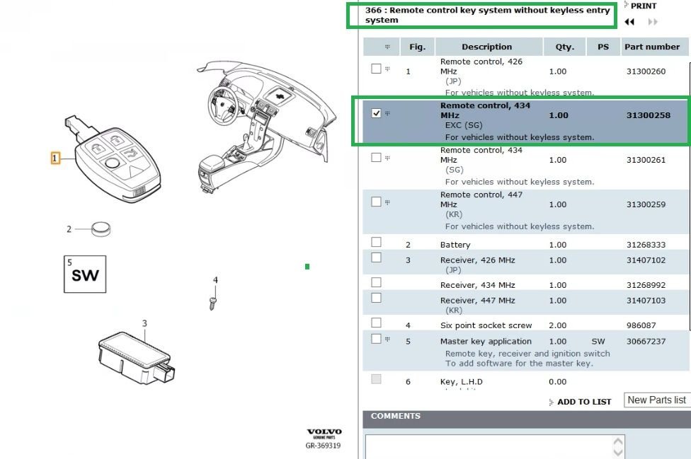

Here's the parts page for without keyless entry
You do understand that for your new replacement key to actually start the car and the remote functions to work - A software download using a VIDA subscription (and a DICE unit) will be needed? How was that activity going to happen?

Your provided link suggest that 31300258 is the one. However, I've also seen 31252732 as a valid part number for the same vehicle without keyless entry, and this one is about $100 less expensive (prior to programming, of course).
