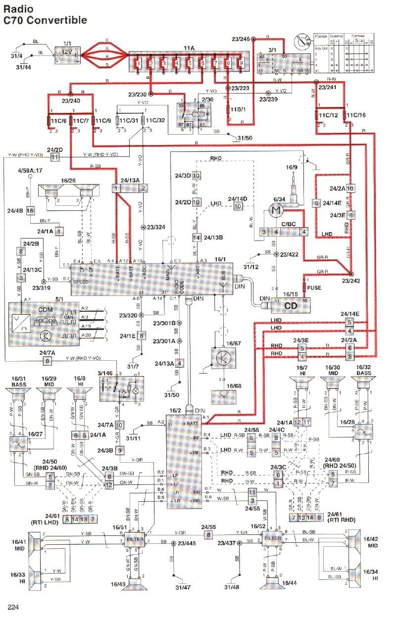

The 3 cd units don't have an amp in the unit other than for the center speakers. All the other speakers are powered by the external amp.

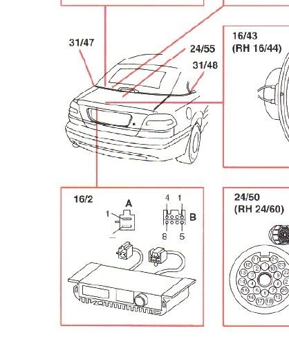

Amp appears to be mounted in the trunk on a c70, a lot of other Volvos it is mounted under the rf seat. Note there are 4 crossovers in the system 16/51, 16/52, 16/28, 16/27

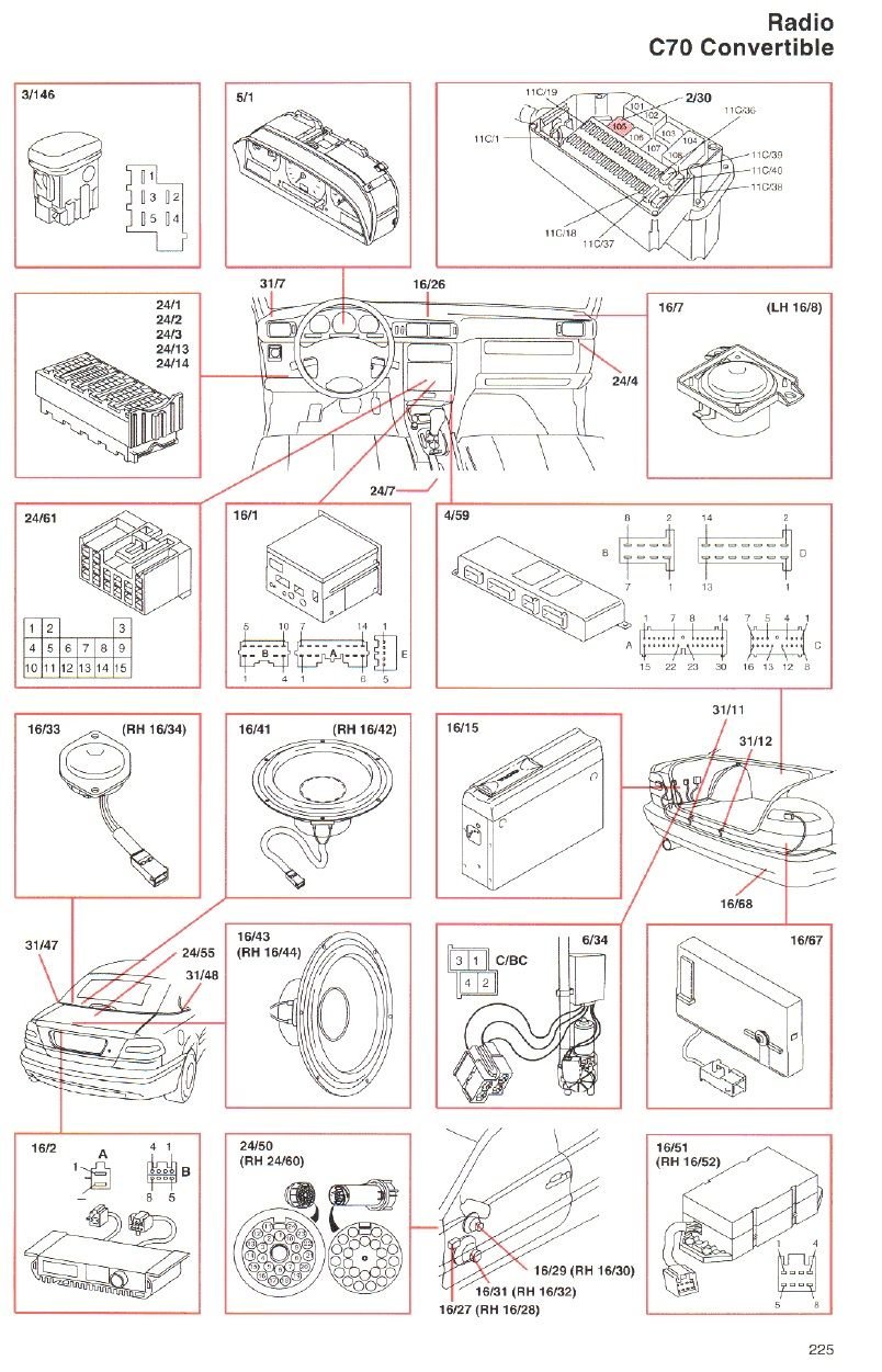

Here's the complete component location page. The amp won't be exposed in the trunk - it will be under the trim panel. Note there are only 4 speaker outputs on the amp - 1 to each corner of the car. So if any speaker in the group of two or three in each corner is working normally - the amp is doing it's job - leaving only the crossovers to be a problem.
