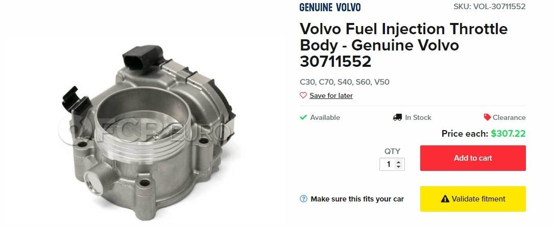

A throttle body for a 09 c70 is a 30711552. New those are ~$300 - $600. Note they are on clearance at FCP - that means "we bought some and nobody is buying them because they don't go bad, so let's get rid of them. That said the bosch throttle modules are very reliable and rarely fail. Your code (whatever that is) I trust points to the signal from the throttle module. That does not mean the throttle module is bad. You need to find someone to diagnose the problem rather than replace parts by code. A good technician with the right tools should be able to test and duplicate what is causing the "code" to appear BEFORE buying and replacing parts on a guess. Yes it's hard - and possibly it's above your guys pay grade, quality of tools he owns/has access to or his diagnostic ability. A problem with earlier cars was the electrical connection at the throttle module - Volvo developed a service solution for that and replacement wire connectors solved "bad throttle "codes in those cars. Throttle body is held on with 4 bolts an electrical connector and a hoseclamp. Replacement is not the hard part - the hard part is a correct diagnosis. Does the car run badly? Do you need the CEL off to get an emission inspection?
