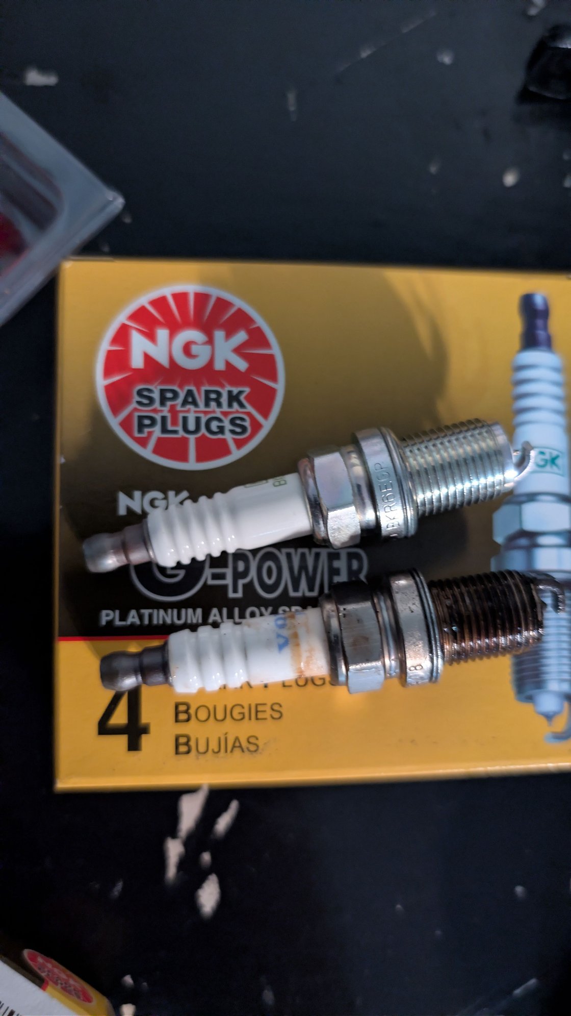

Seriously, this made reassembly effortless. I just looked back at my phone and matched everything up exactly as it was. As a bonus I have been recording all work I do as a learning lesson for myself and something to look back on. still torn on if I want to start a small youtube channel to throw all this on.
old vs new plugs. they were in ROUGH condition
this was a pretty fun thing to do. I have never tried plugs before on a car and this volvo made it a pretty simple first time.
