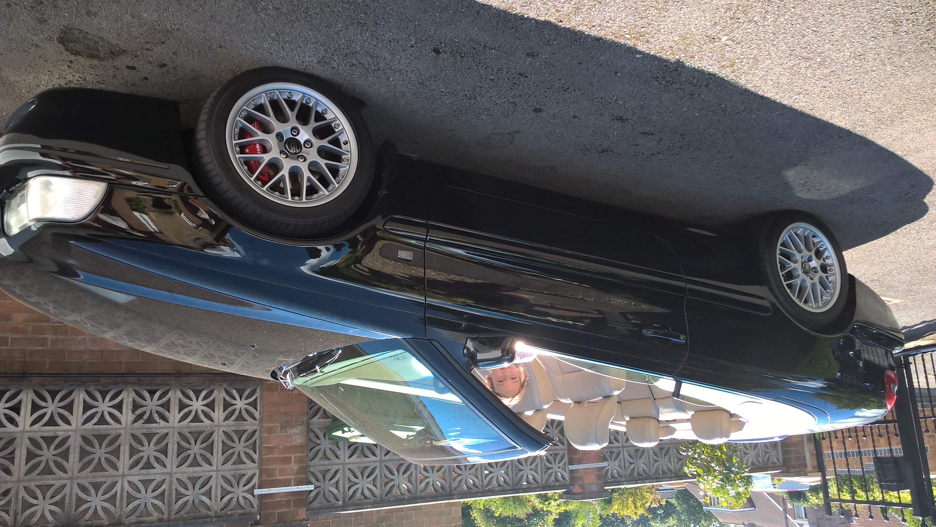

i have a c70 2.litre turbo with 67000 gen miles on a 51 plate , it has a steering whell vibration at low speed that dimishes at higher speed above 20mph ish , have swap wheels so front are now on back but still does it , also wheels are alloy bbs type , just wondering if needs tracking or inherant problem with these , got 10 months MOT on her ad seems hpi clear from records been well looked after with around £5000 of receipts sorry for upside down photo
