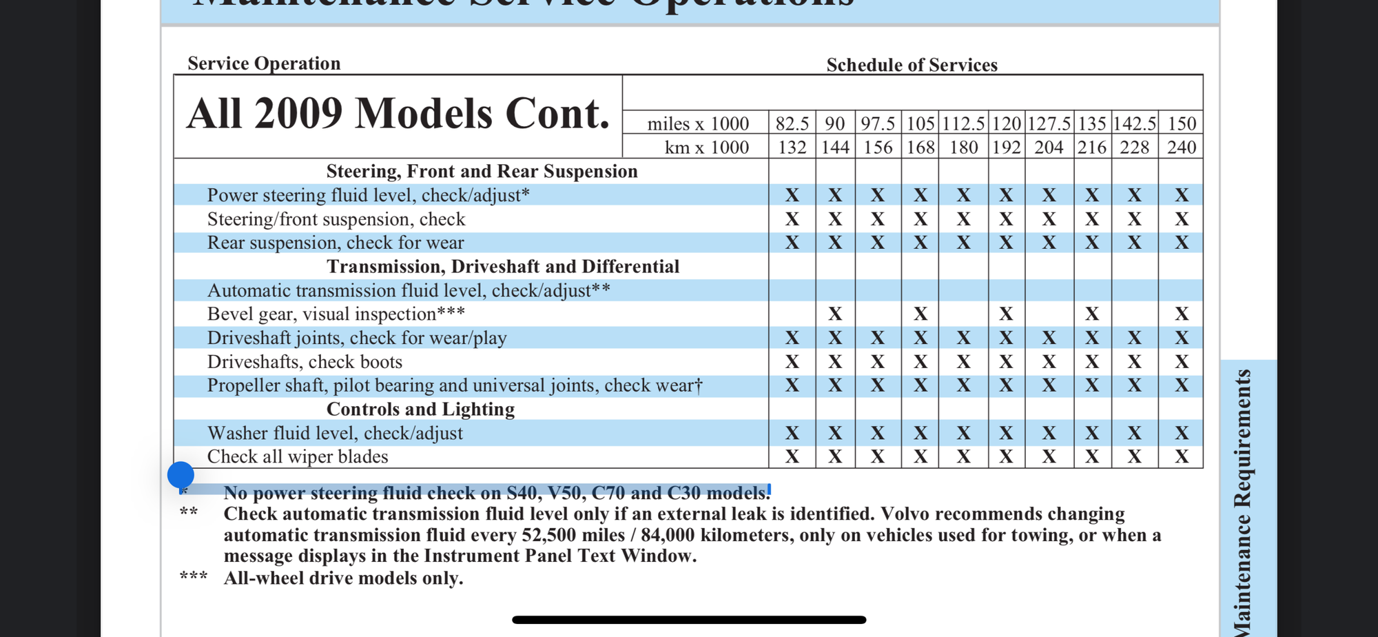

This morning, while trying to troubleshoot, I checked the power steering fluid (took the passenger headlight out to access the reservoir), and noticed that there was no dip stick on the cap or any way to see a min/max fill line. When I look inside of the pump, I can’t tell, but it looks like the fluid is low (see pictures attached). I checked the service interval for power steering fluid flushes, and the Volvo manual said that there was no required changes and the fluid was lifetime (see screenshot).

Today I changed the fluid on my P1 2009 C70. I just used a turkey baster, took off the cap, pulled as much out as I could, refilled with new fluid, turned wheel lock to lock, flushed again, and refilled until it reached the bottom of the neck (definitely more than there was before, ended up using a qt and a half, so buy around 2qts if you want to flush it multiple times, I don’t think multiple times would be totally needed, but I wanted to anyways). I think that refilling probably would’ve fixed the sound, but (despite Volvo saying no change is ever needed), I’m happy I changed the fluid after 135,000 miles. I think I didn’t get ALL of the old fluid out, but leaving a bit of the “indestructible” fluid in there won’t hurt much. Hope this helps anyone with a P1 Volvo and Power Steering Fluid issues.
