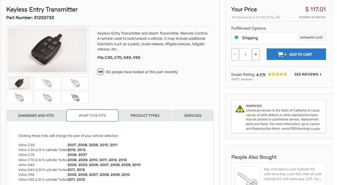

There appear to be many for sale when that part number is googled - perhaps ask a different dealer. The dealer (or anyone with a VIDA supscription) will need to "program" your car to accept the signal from the new remote and key for them to work. I've never done that on that type of key (have done many on the 99-07 cars) so I can't describe the exact process. (earlier cars require 2 downloads, one for the immobilizer chip in the key and one for the remote. On the earlier cars you can't make a used remote work - without the code printed on the bag the remote came in when new)
