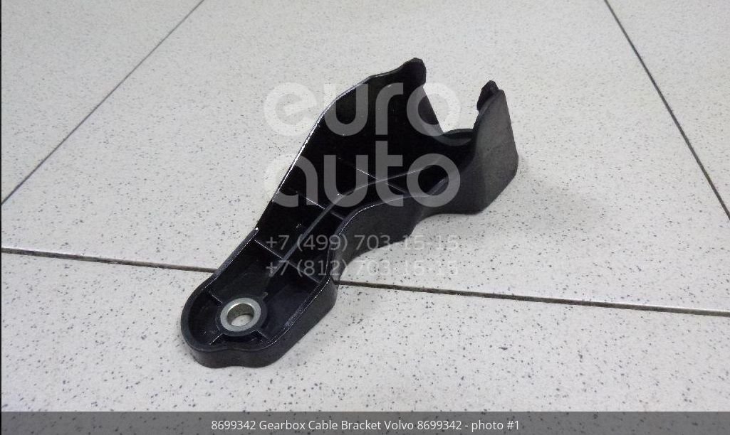

Hi
I've searched the web and this forum for an answer.
The gear shaft skipped out, it's now back seated. I'm trying to identify the plastic housing as it looks to be partly broken?
I had it parked on a hill, park brake not engaged. It was shifted to drive and then all mayhem broke loose

What year, engine and trans? What country?
2012, T6 AWD, D5 engine. Sold in Poland/EU
Old Nov 9, 2022 | 08:48 AM
You have posted in the C70 forum - Is your C70 AWD?
Or what model Volvo do you have?
For a v70 the part is a 8699342
Thank you sir, I really appreciate your help. That's the part.
