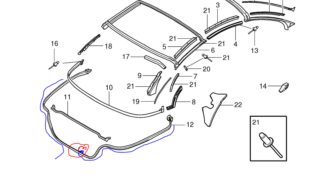

2011 C70 Hard Top - Water Leaking over Trunk Seal at bottom as seen in the picture diagram of the seals (red is spot where it leaks into trunk, blue is the water as it runs outside the seal. Seems to run all the way down to where lid meets trunk and over the right half of the seal. No tears or anything in the seal and seal is not flat or misshaped when compared to opposite side. Seal is installed properly over the top of trunk plastic trim. Any idea if the seal needs replaced or something else going on?

I have the same issue, and I observed that both the small holes near the edge of the seal #12 in the figure of Azon2111 post are clogged, so the water cannot flow away and probably goes in the trunk as explained in figure #12, any news for the solution?
