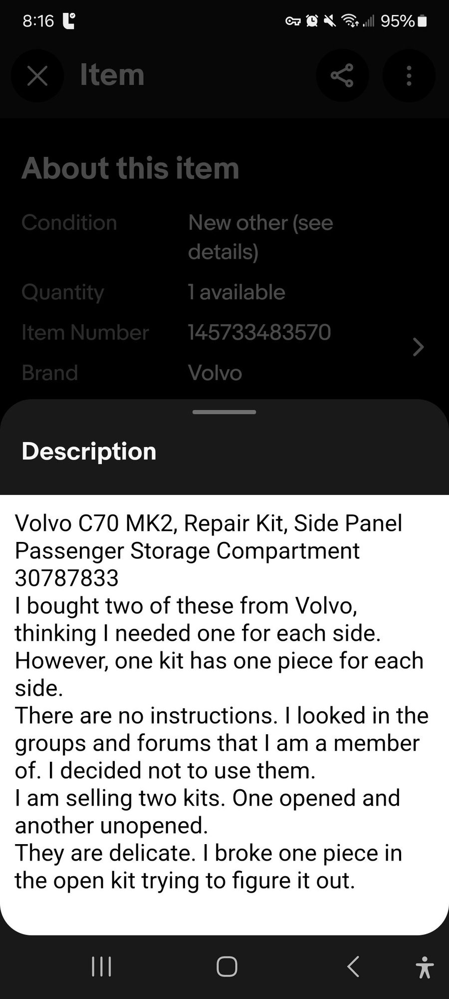

I'm reluctant to promote this listing, but someone may want to try it. I'm thinking US only as I've never done overseas before. https://www.ebay.com/itm/145733483570
Old Apr 20, 2024 | 08:41 PM
Brownaar's Avatar
Joined: Mar 2022
It's probably identical to the kit I bought, and if you look at the listing, in one of the photos one of the pieces is broken.
Old Apr 21, 2024 | 07:19 AM
celeste_c70's Avatar
Joined: Jul 2023
Posts: 6
It is my listing, and in the listing, I explained that one piece of the two kits is broken.
